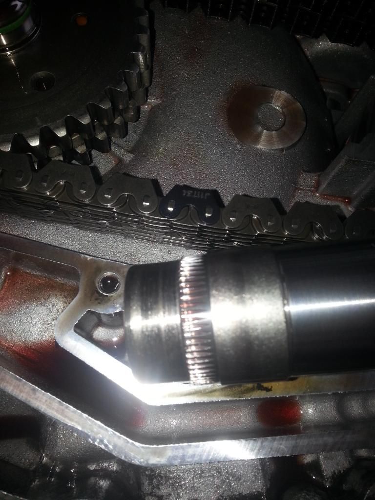

http://i1006.photobucket.com/albums/...ps6aoyyxoj.jpgURL=http://s1006.photobucket.com/user/m17davis/media/Mobile%20Uploads/20140603_124330_zpsrqn989qm.jpg.html]http://i1006.photobucket.com/albums/...psrqn989qm.jpg[/URL]
Do they even look bad?
You bet they do. That is supposed to look the same, all the way. See how the part furthest on the shaft is beefy and the rest is crappy. Replace ... and you should have 4th again.
good thing is thats a 40 dollar part now a days.
