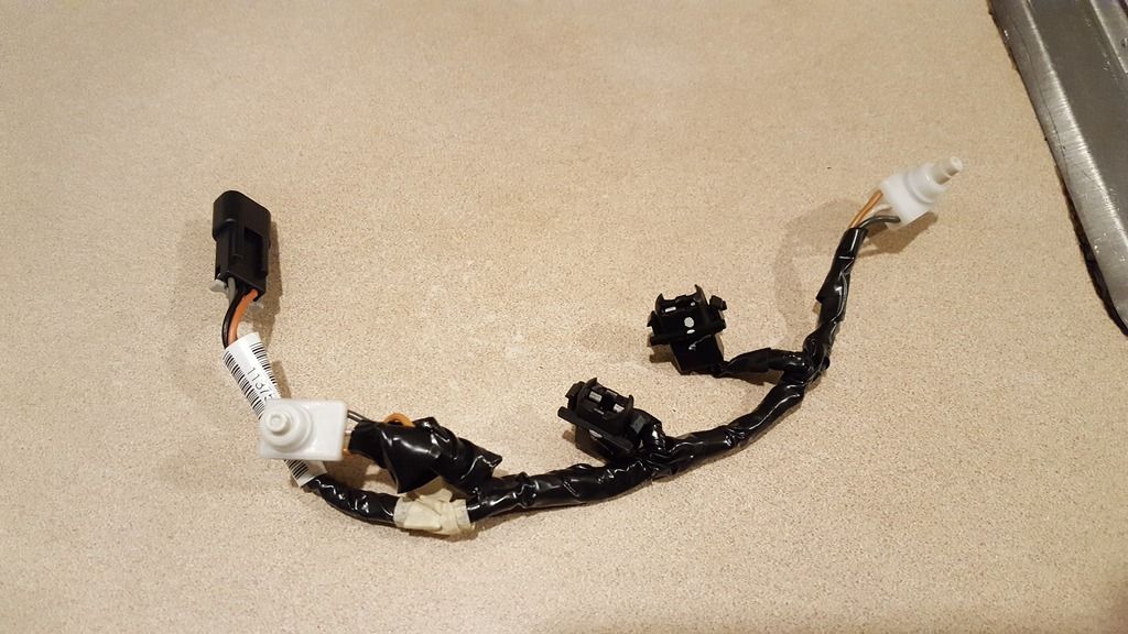

    There are switches in the harness that the lenses press. If you pull the dome light assembly down there is a plug in to be able to remove the assembly. Then that little harness has the two plugs where the bulbs plug in and the two little plastic switches.

    I didn't get to this yesterday, but I pulled the dome assembly down today after work. I was able to semi-repair the switch, but still am probably going to need a harness.
    The pic
    The dome lights are 194, but even if you have a 97-03 harness and the switch is the same then that's fine. I'll just cut and splice into my harness.
