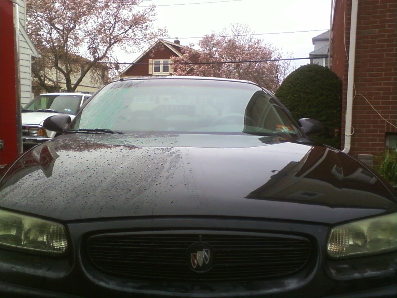

this is what i used last wax job, not happy with it, does not last more then a month or so. glad my brother bought it and not me lol

im pretty sure this pic was taken about a week after i last waxed it. that ultimate liquid worked damn good. as you can see. but did not last. if you could wax every other month it would work out fine. the buffer i use is my brothers, so its 50 miles away.

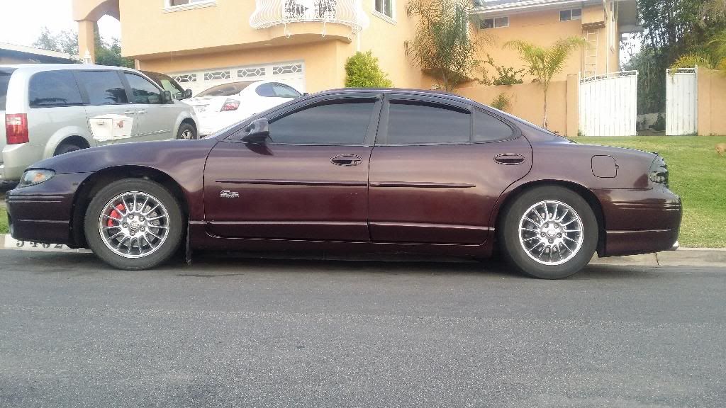

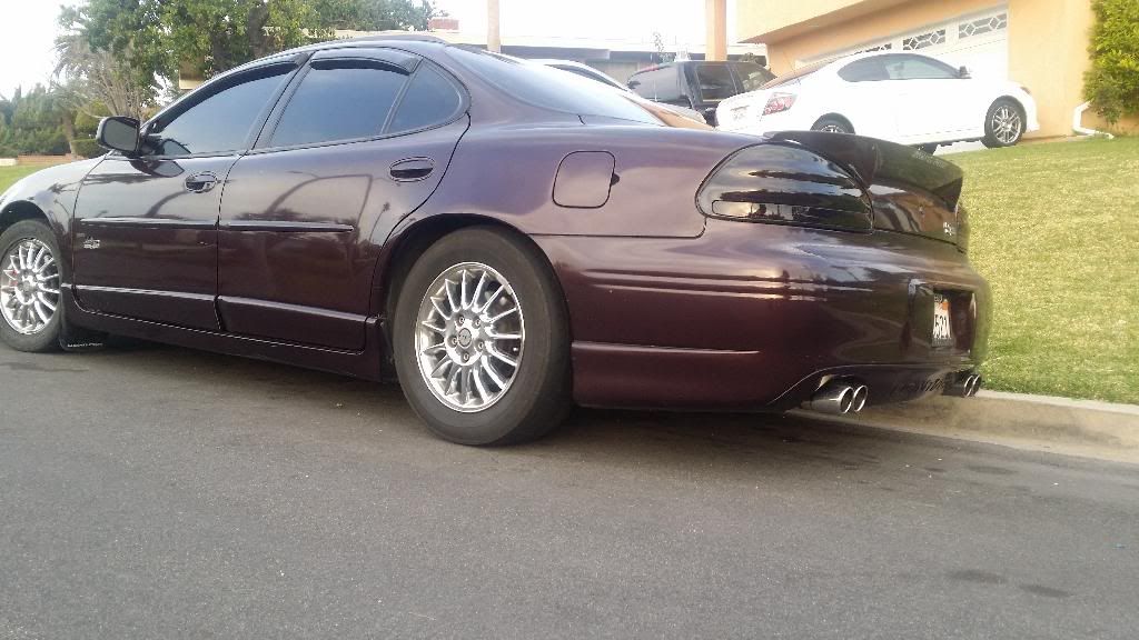

Thanks for the help guys I just lowered me car. Will be adding the rims and cts v brakes real soon but want the paint to look at least a bit nicer.

Don't mind the burned paint on the bumper.
http://i72.photobucket.com/albums/i1...323_182731.jpg

i got ya on this one, it beads up for sure, and then stops, and looks like crap unless you re wax it.
im not showing the beading up per say. its the reflection. and 6 months later its pretty much lost all that shine too.
ive used a bunch of meguiars products over the years, that ultimate fake wax was a big let down. the swirl removers and polish and wax all seemed to work great in the past.
