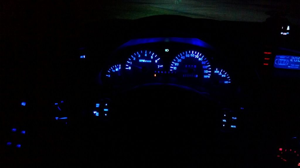

    what i did was remove the red film and retrofit several sections of LED strip. I will try and get a picture of the finished product later.

    the picure makes it look much worse than it is. Everything is a fairly even intensity.

    so im assuming you just got some of the basic strip led's with sticky backing and stuck them on the gauge cluster back? and do you have a picture of how you positioned the led's? also, was is labor intensive, or is it something i could do in like 4-5 hours.

    I ordered the 5 meter roll from Amazon. Yes, it has an adhesive back. It's a bit labor intensive, but very doable. I have all of these strips powered from a single twist-in plug from the gauge housing. I also put in a 470 resistor to dim it down a bit when I redid it. It used to be stupid bright. I'll see what I have for pictures of the cluster guts.
