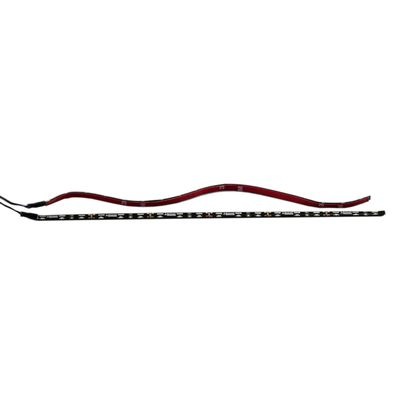

I went into walmart and got inspired since the start of this thread LED's have become way less expensive so tomorrow I am going to put leds under my projectors to get that Audi look...
http://contentinfo.autozone.com/znet...77015/image/4/
and get some directional white leds to serve as the underbody neons...

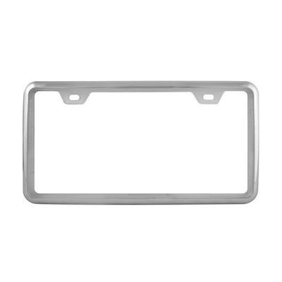

I already wired the pilot led lice plate light to serve as my license plate light and it passed inspection...
http://contentinfo.autozone.com/znet...04-RW/image/4/
