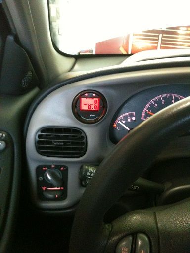

    Aeroforce in my 01.

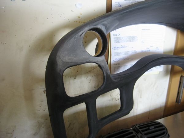

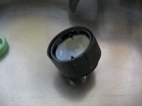

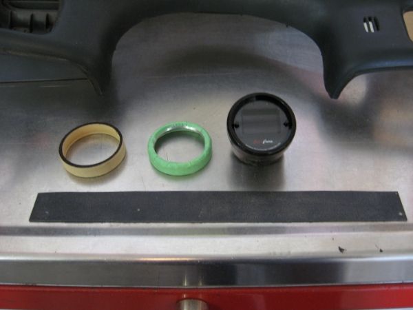

    thats awesome... did you use some kinnd of blacnk for the guage like a plastic tube for it to fit into?

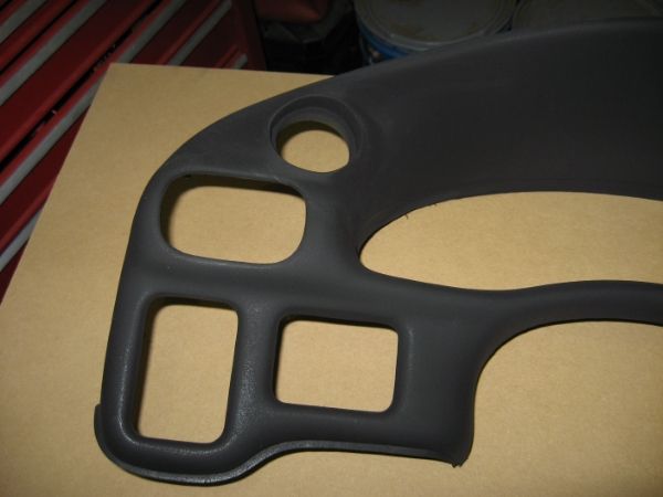

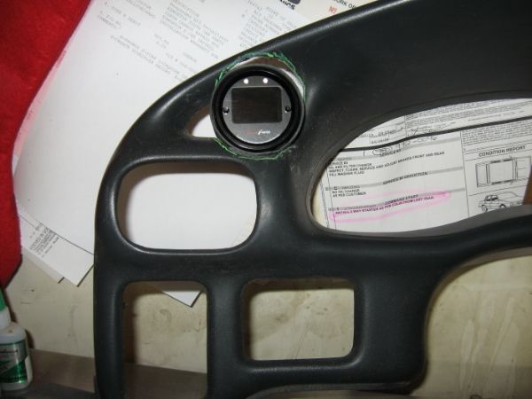

    Thanks Doug, Here's a couple build pic's to give you a idea on how I did the bezel. Some of the materials used were a ten dollar junk yard bezel, wurth two part plastic apoxy, Sem plastic adhesion promotor, Sem texture spray and Sem GM med gray paint. Feel free to ask any questions. Evan

    where did you put the fog light switch?
  10. #130 Re: Lets see them guages !!!!!!!!
    SE Level Member Eking's Avatar
    Jun 2010
    Canada
    18
    I Extended the fog light harness then mounted the switch out of sight but still accessible under the driver side dash.

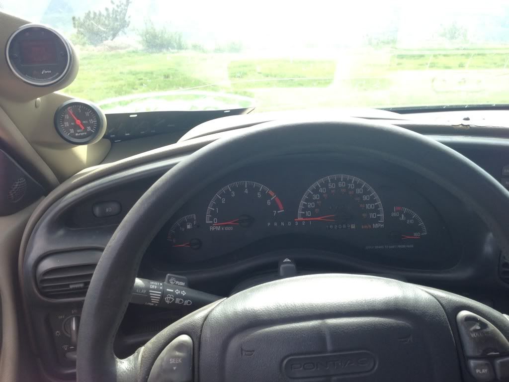

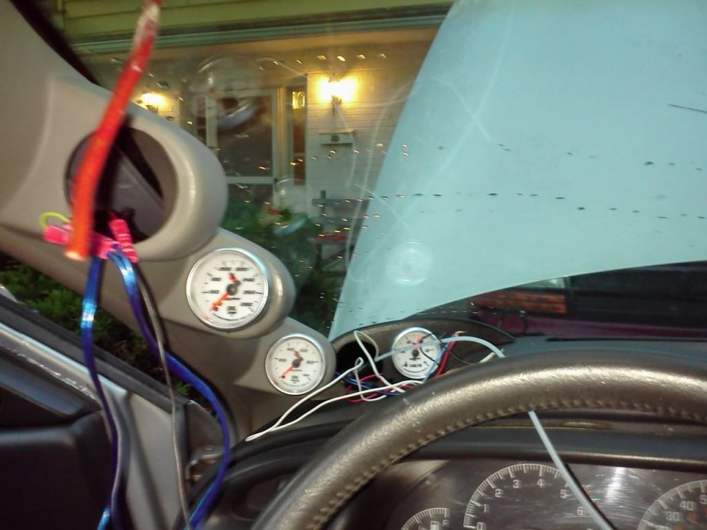

    A work in progress...

    Trying to copy me on the 5 gauge set up now, huh?
  14. #134 Re: Lets see them guages !!!!!!!!
    Banned
    Jan 2013
    Colorado
    1,524
    I guess, I'm sure a lot of people rock that setup.

    Nope. Just me.
