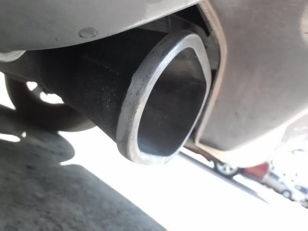

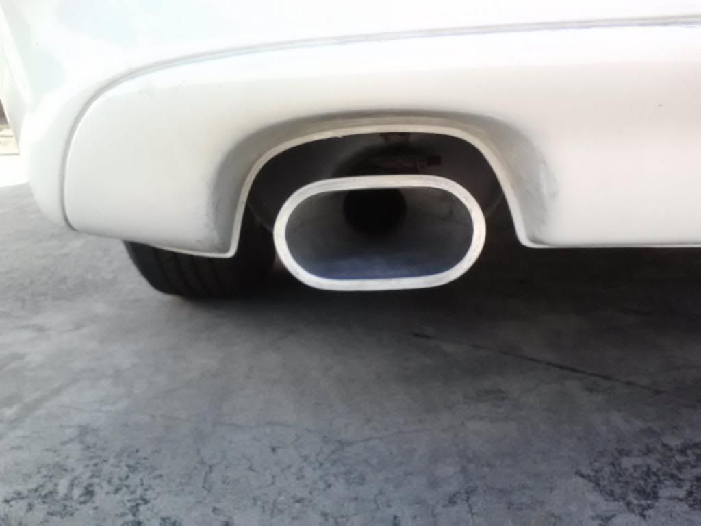

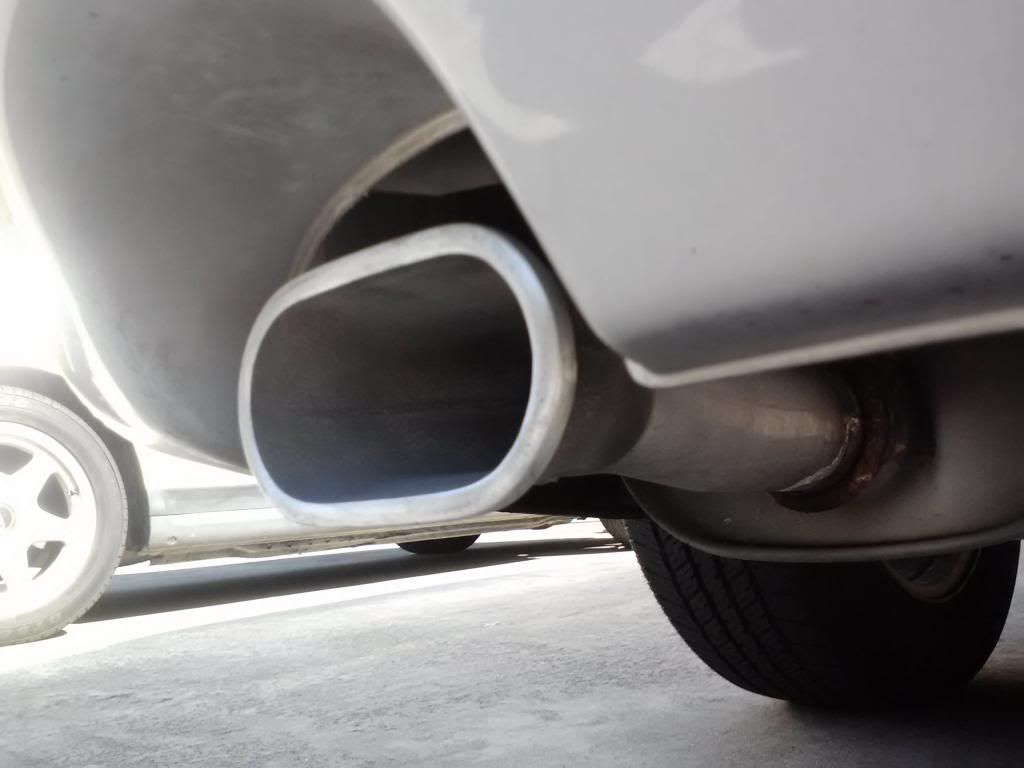

    Hello, I want to polish my tips, they are rusted to hell and someone from the forums told me to use 120 grit sand paper. I started on my tips and my neighbor came out and said I am going remove the chrome from the tips with that sand paper. Now im confused what should I do, use the sand paper then buy polisher or I don't need the sand paper at all?
    Quote Originally Posted by Lishap View Post
    I just hit mine with like a 120 grit dry IIRC but then i just got new tips.
    Here a pic where I started to sand. (only 10-15 secs in)
    This is what they look like:

    THERE IS NO CHROME, its aluminum. Clean away and get rid of the nasty then hit your neighbor on the forward assist.

    There is no chrome on the tips. Continue sanding as you were; you can go to a finer grit after to smooth the aluminum out.
    I did as above, and use a small piece of SOS pad every few washes to keep the "silver" colour alive.

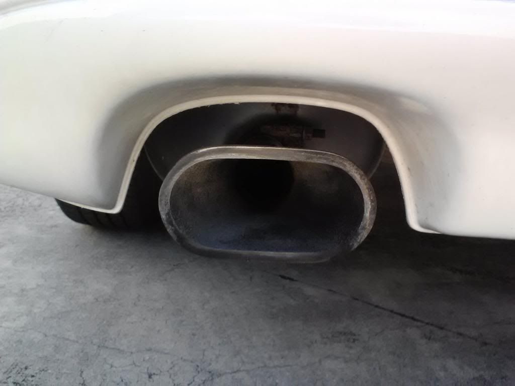

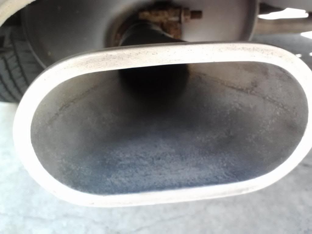

    So far so good. Did the inside too, I'm anal about detail

    Nice, like night and day when you clean those things.

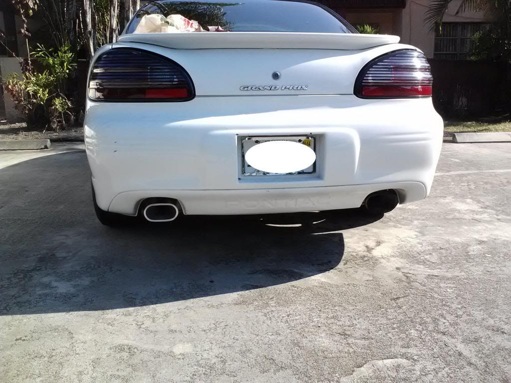

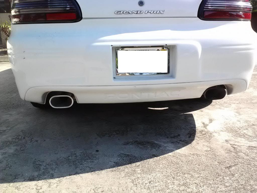

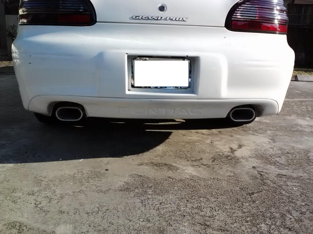

    Finished, I am exhausted! I hit them with some metal and chrome polisher after, give them a little shine.
    Here is the right side:
    Both: sun is going down, so I got a bad shadow. I will take a better picture tomorrow.
