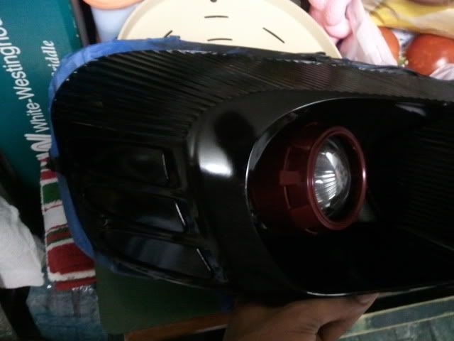

    This is one of the headlights I've done in the past..
    Similar to what you'll be seeing in the road. Notice how the light doesn't scatter

    Here's one of Drunkie's sets that he did.
