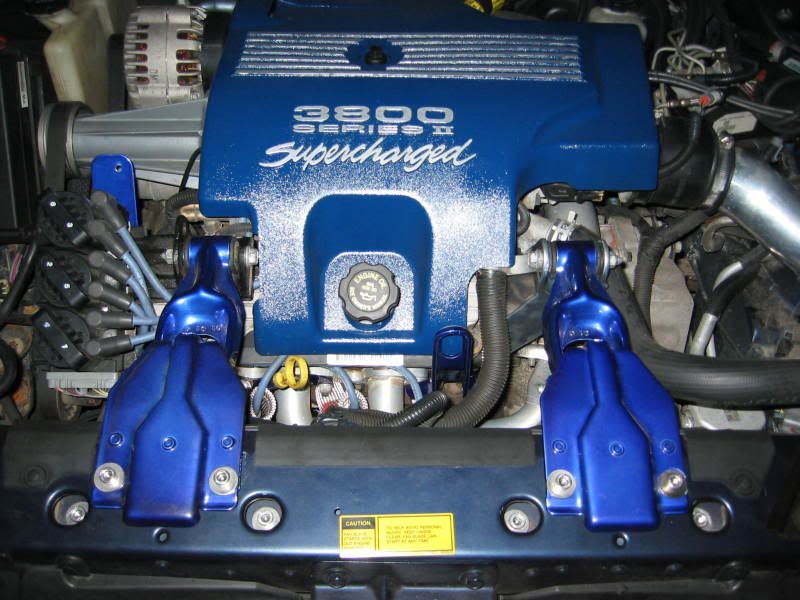

    heres what i came up wid...yeah yeah i know i suck as an artist but hey i can always pay to have it done RIGHT!

    o and please dont ask about the oil cap...LMAO, it had some oil residue on it and paint wouldnt hold to that. good thing is the crap will probably wear off.

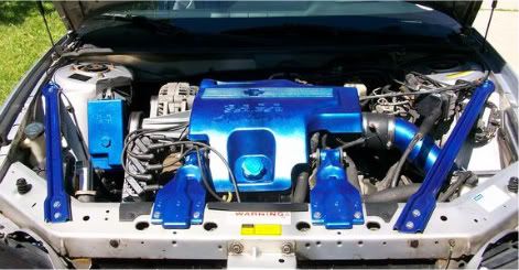

    I used the same stuff, krylon fusion. Mine is painted blue. I have painted 2 different covers now and have seen any sign of stress/wear on it. No primer, just take some scotch brite, scuff it up, then use some water and soap and clean the cover. As long as there's no engine grease on the cover, it'll do just fine.

    nice fatride...how did u do the superchardged symbol? I used a regular paint brush to do that part, carefully took time
