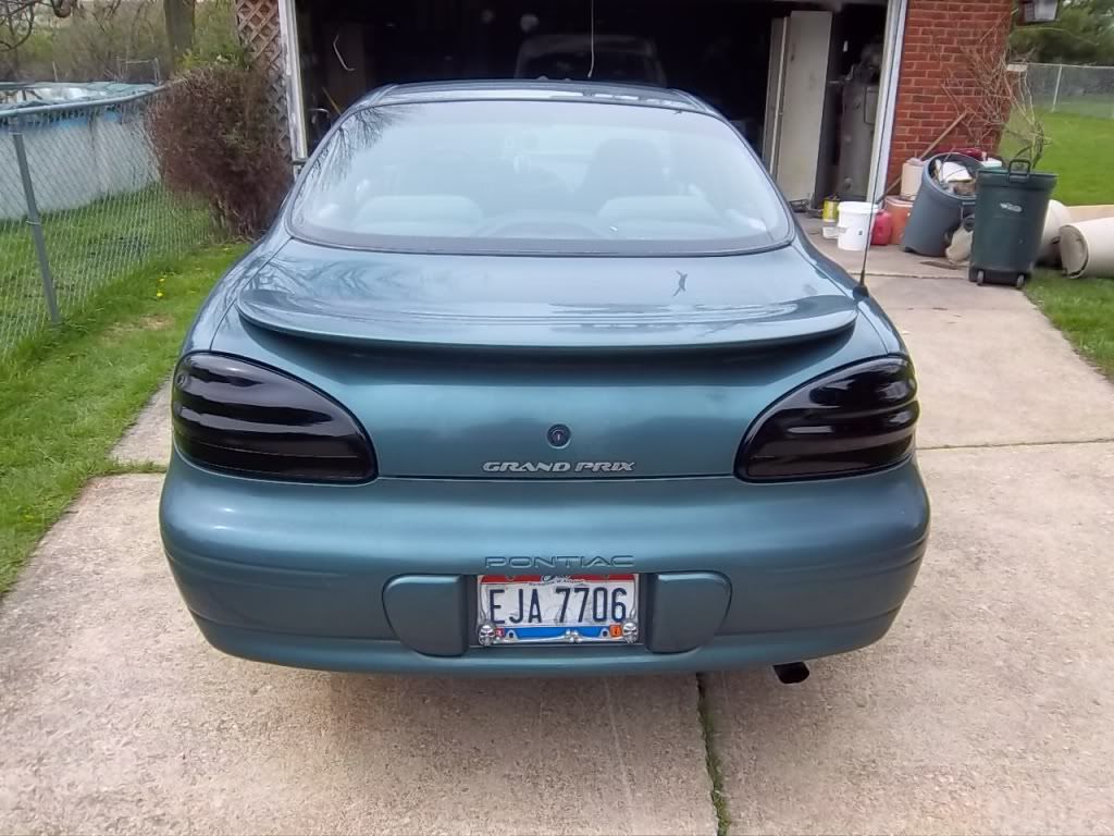

    My Taillights where Just as Bad so i just Tinted them they look great on sliver cars.
    there Very Dark but they look amazing At night and during the day.
    The sealing yes, use Black or Clear Silcon. And make a 1/4 inch Line all the way around. Also fill around the Reflector And smooth it out so its level with the rest of the light then if tinting sand with 600Grit and then u get to choose how dark u want.
    Message me if u need anymore info on fixing these up mine were totaled like fish bowls and shorting my Blubs and fuses, after the sealing there hasnt been any water in them. and the tint is amazing
    Mine are the darkest u can go before there no longer transparent

    hey man, if ur using vht nightshade, which im guessing u r, u dont even have to sand them. 600 grit is way too rough if you would anyway for a lens man. all u gotta do is mask em, clean em REALLY good with a acetone, or prepsol, then lightly rub them off with a tack rag. just spray and play after
    the reason u dont gotta sand em is cuz nightshade has a built in adhesion promoter called ketone or something. so it sticks right to ur light.
    mine
    To seal them i didnt sand.
    Before i painted i did 600 Girt and mine are Prefect. and look amazing man.
    I painted them with Transparent PPG Chrysler Black.

    well u didnt use nightshade so u would have to sand them so u did it right
    but redline, like i said u dont got to cuz of the adhesion promoter. but scuffing REALLY lightly wont hurt.

    Well when your Taillights are trunign white cause the 2 lens are ripping apart. its easier to just Black out the lights. and yes light tint is good
    My Grand Prix has 10 Coats
    this is 3 but the 300 stock Lights r dark to start with.
