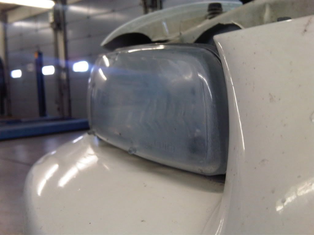

    This is what your headlight looks like when you take about 1 hour (20-30 minutes each system) use the 3M system (sanding pads) and the Meguier's polishing pad, and rubbing compound/ Meguier's plastic X with a crappy drill:
    This is what 5 minutes, the Meguier's polishing pad (comes in their headlight kit), air die grinder, and rubbing compound/ Meguier's plastic X. I did not go back and use the sanding discs. You can also use toothpaste.....
    Is it perfect... naa, but it's a ton better!

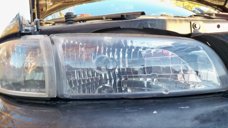

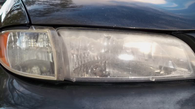

    Ok finally had some time to do one headlight today and I didn't get the 3000 grit but regardless it came out great in my opinion. Here's a before and after picture of one, the other is in worse shape and I'll take more pictures of the process.
    Before:
    After:

    1,884
    ^Wow turned out a lot better than I thought it would.

    Yeah it did it almost looks like a new headlight now, the only thing that I didn't like was that the little alignment post of the headlight kept getting in the way and made it harder to do.
