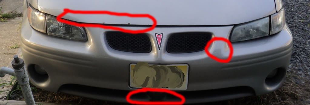

    Hey everyone, my 98 GT Coupe has a few spots on the hood and front bumper that are either missing paint and rusted or scratched about a millimeter deep.
    I got the touch up paint (Silvermist) and a bottle of clear coat, both a 1 oz bottle with a brush.
    How would i go about applying the paint to the car? Would i sand the rust?
    I just need some pointers about putting touch up paint on a car because i have never done it before.
    Thanks alot.

    Got pics? It will help us help you.

    the only rust on there is the top on the hood... the bumper is plastic.. no rust there..probably just paint chips.

    Quote Originally Posted by bigtom9492 View Post
    He said rust and paint chips in the post... =P
