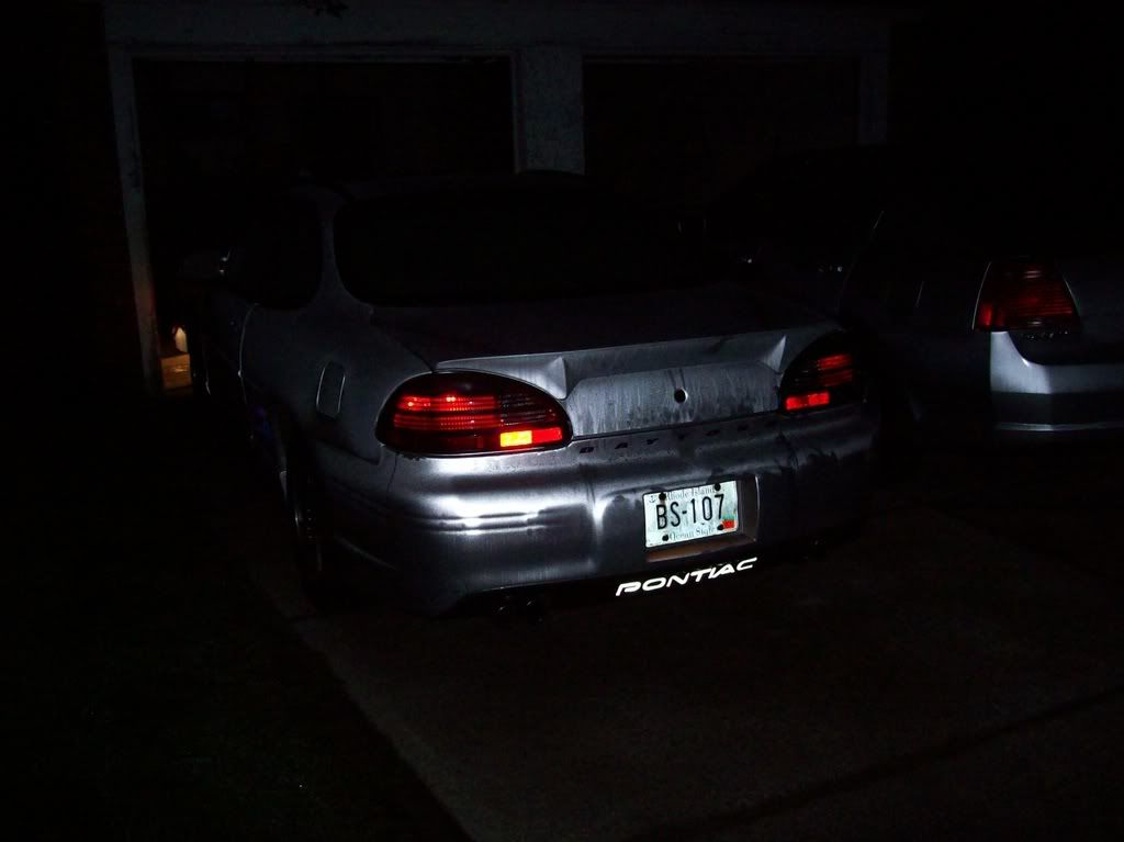

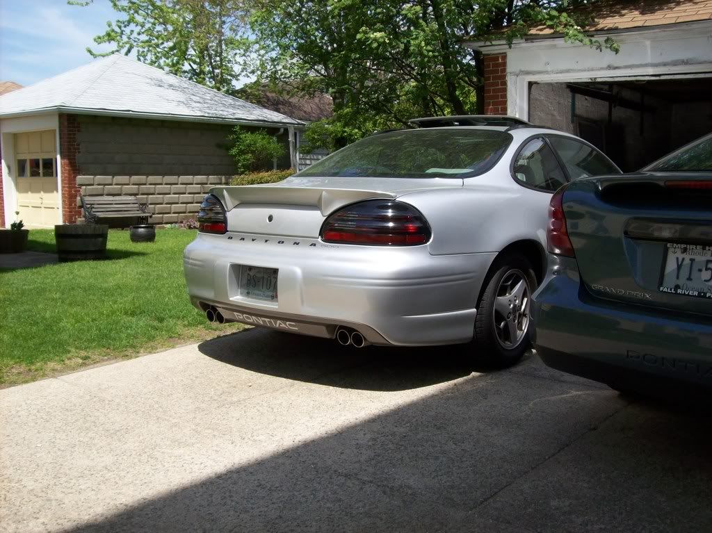

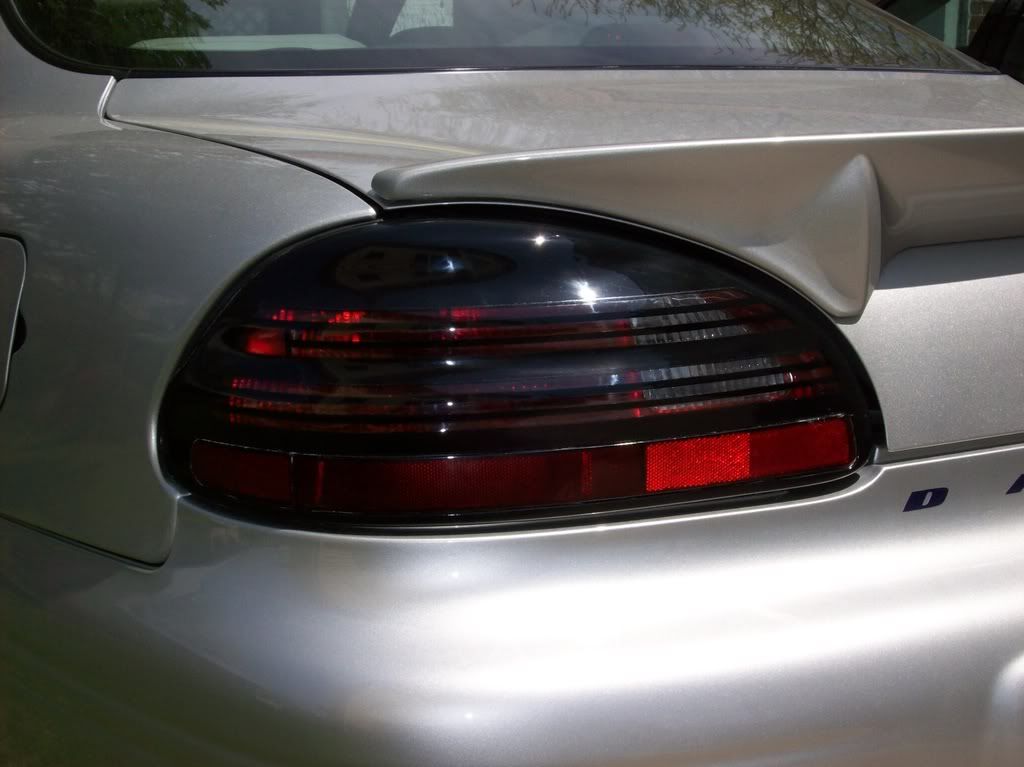

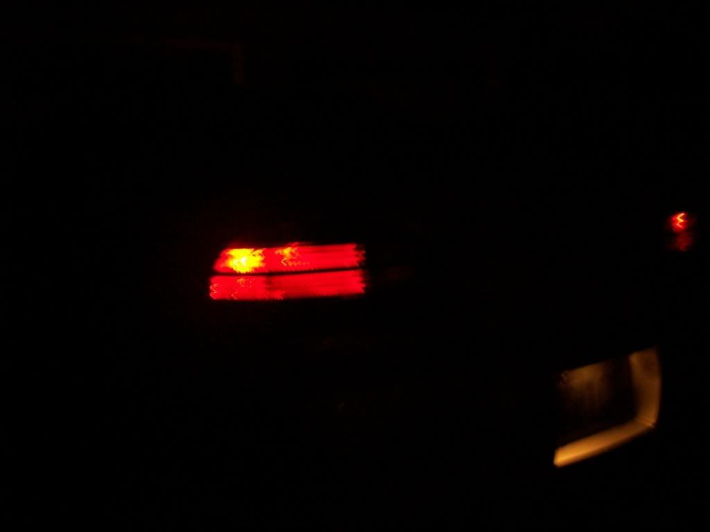

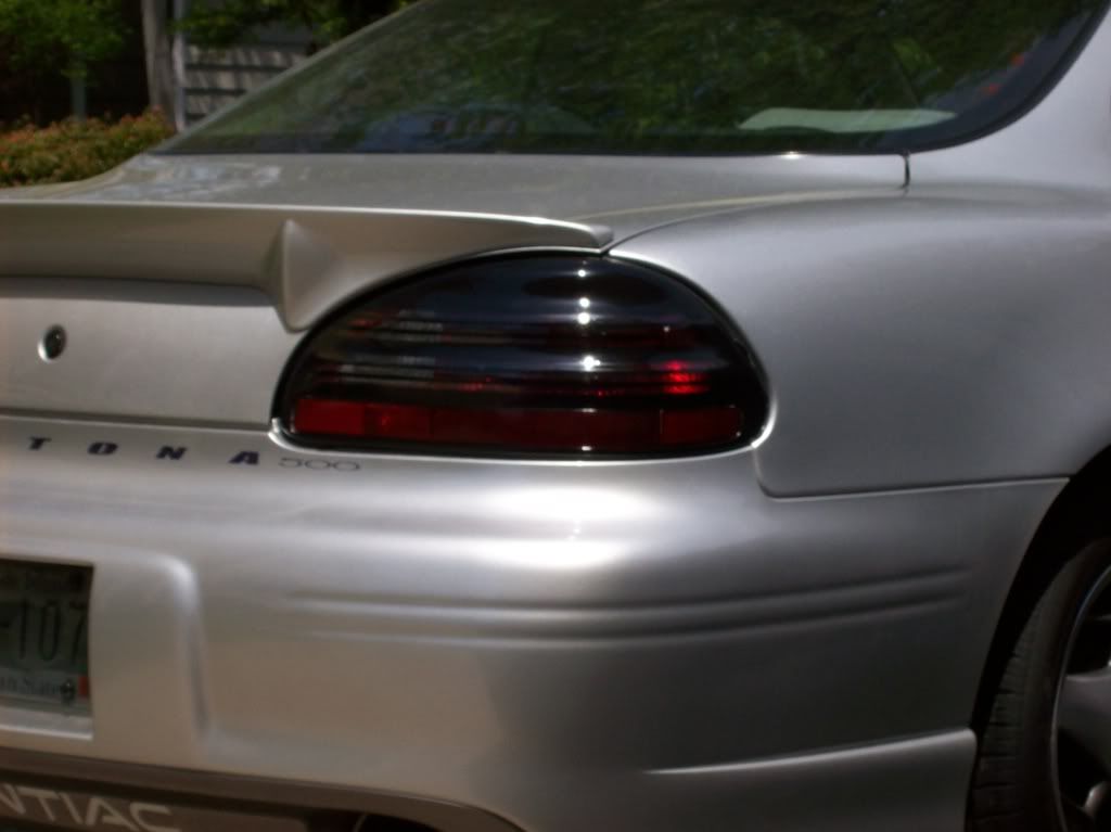

    As for the design, I was inspired by Sonny Rooney. I wanted to keep the red reflector to stay legal, but wanted something a little different than the usual tinted tails. I used Krylon Fusion Gloss Black and a ton of clear to get them shiny. I wet sanded with 2000 then hit it with Mother's scratch remover. For my first time, I think they came out pretty good! Here are the results:
    From further back they look tinted almost.
    Night time with the flash
    And without the flash
