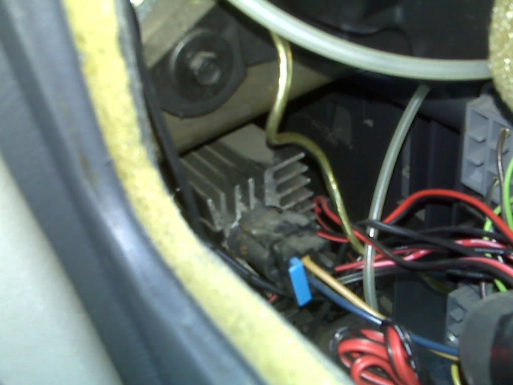

you have to disconnect the DRL diode under the dash.
See the panel on the drivers side of the dash, pop that off, then look in and look for a decent sized aluminum heatsink. pull the plug on that thing and that will kill your DRL's.
