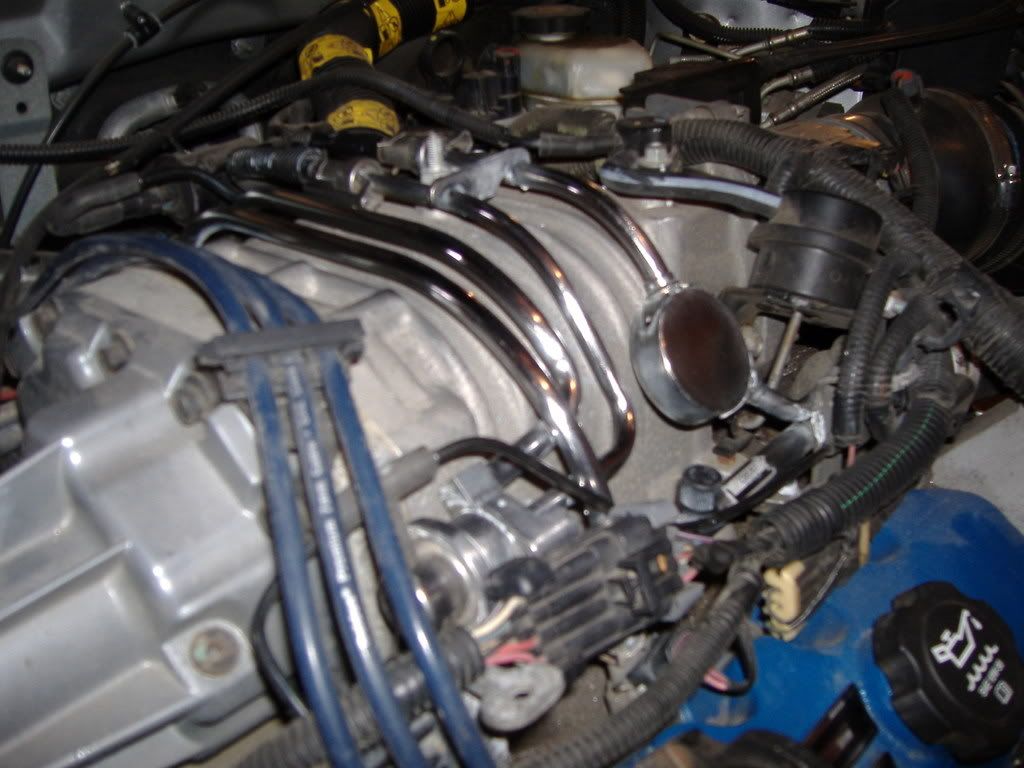

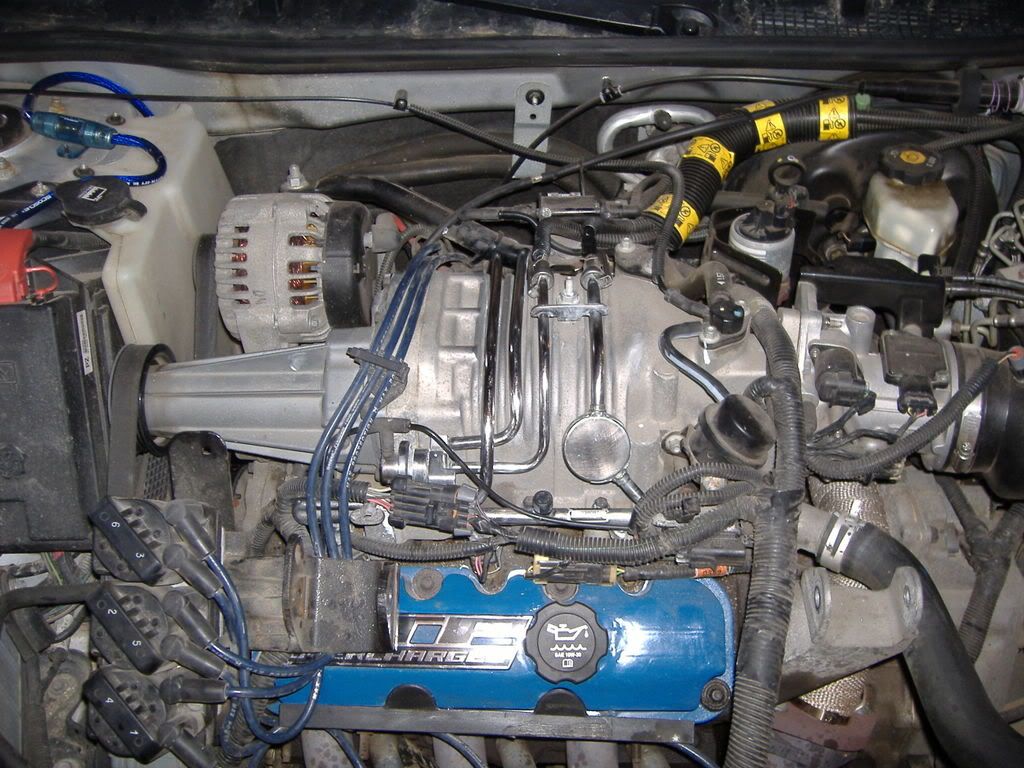

    Took a drill with with some 80 grit sanding wheels followed by hand sanding with 150 then 450. Finished up by polishing the crap out of them with some 3M Mag and Aluminum Polish.

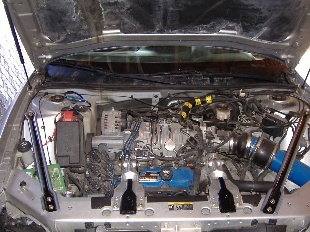

    And one with everything back together.
