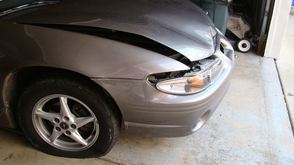

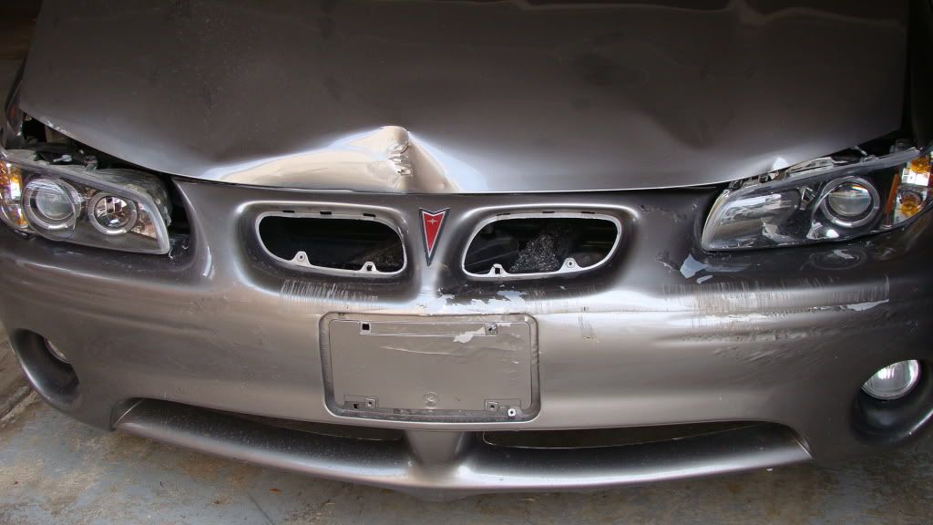

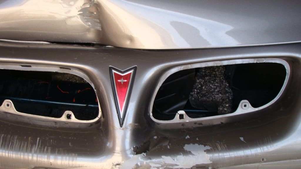

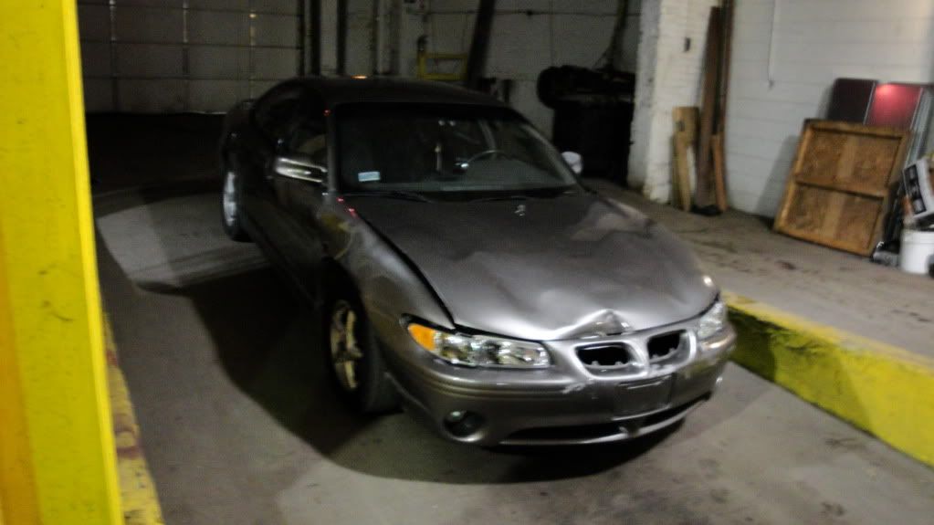

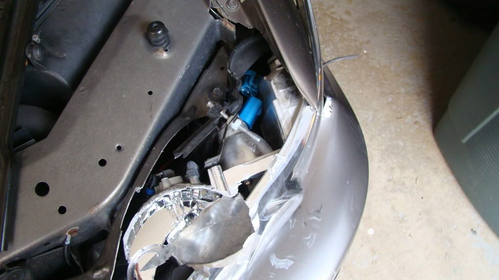

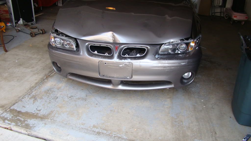

    so friday was my birthday and my first gift happened to be a car accident. Basically my neglect for buying new tires has caught up with me because my car slid going downhill into an old school s-10 which had one of those tough ass metal bumpers. luckily the other guy had no damage on his car.
    at the moment these are some pics of my car. i will be picking a new hood, bumper, and fenders on monday (tomorrow) and will have her painted over the weekend if i can get everything installed by then.
    Known issues...
    Bad tires
    front passanger hub needs replacement
    front passanger rim need replacement

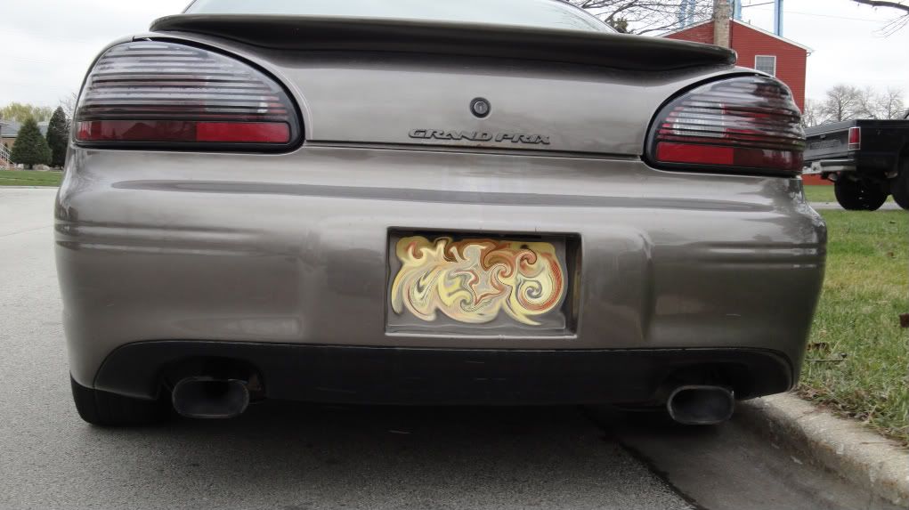

    If your talking about the lower part, u can paint it dark gray or keep it the same color as the car? theres some one on here that painted theirs black.
    What is the back bumper lower color?
  4. #4 Re: Car Crash Reconstruction
    SE Level Member bigboibbp's Avatar
    Chicago
    82
    right now i have the rear fascia the stock silver color it came with, however im having the whole car repainted, am im not sure if i want to make them both black, or keep them a different tone of silver

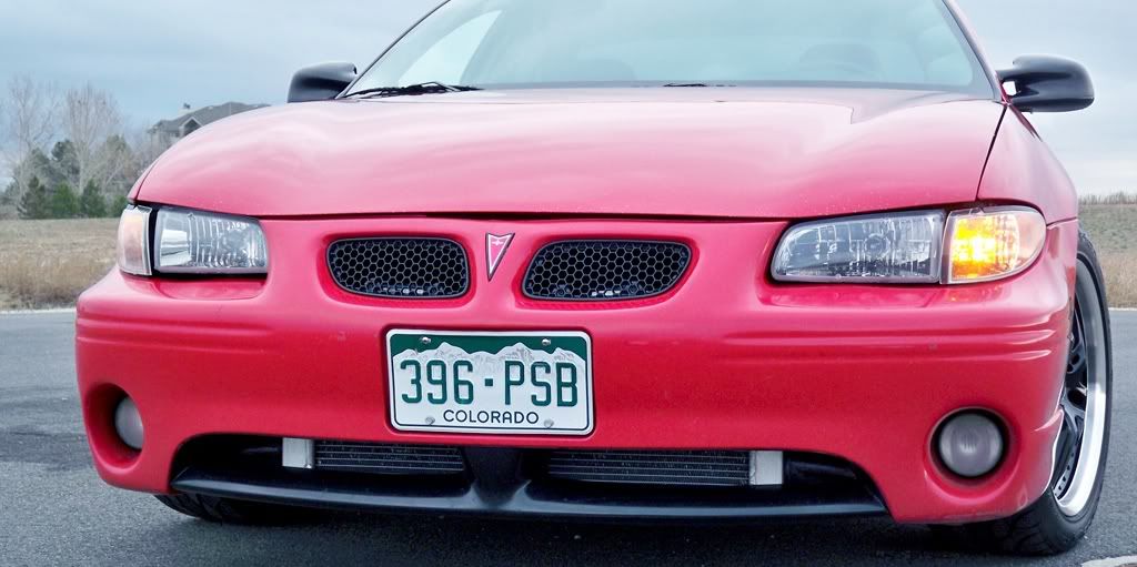

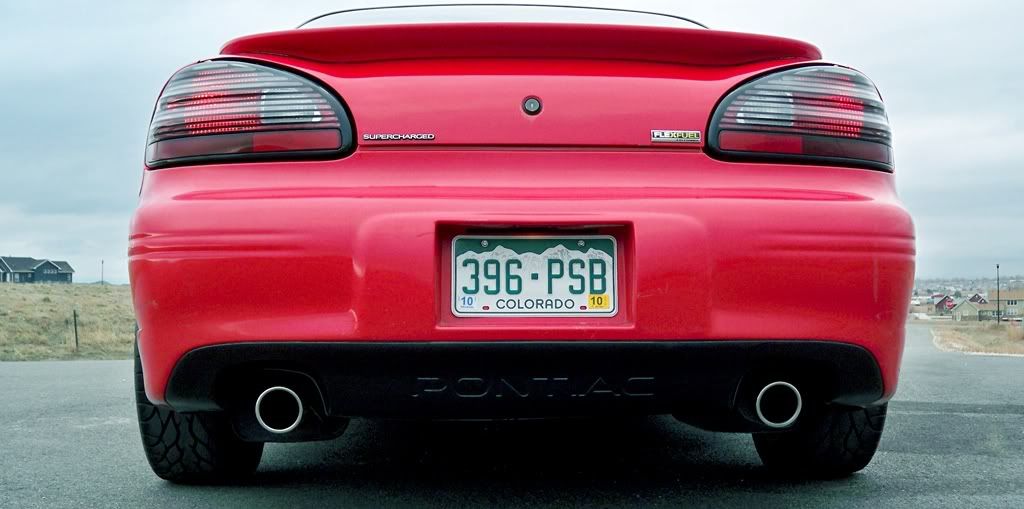

    Lower lip a deep gloss black would look sick.
  6. #6 Re: Car Crash Reconstruction
    Chicago
    82
    thats what i wanted to do but in these pics it seems to take away attention from the fascias
    that car looks good but i think itll take away attention from my car specially cuz the bronzemist is darker then that red... i want something that'll make it pop, and make it one of the first things you notice

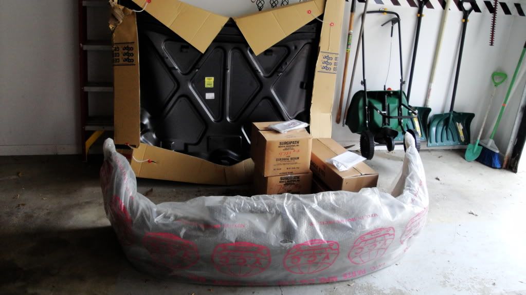

    picture of parts i purchased
    still need a few things but it should all be done this early next week
    in this pic...
    Hood
    Bumper
    Headlights
    Grille inserts
    and headlights for another car

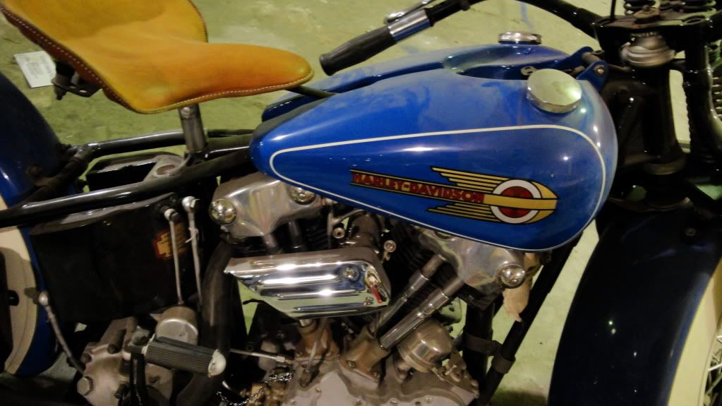

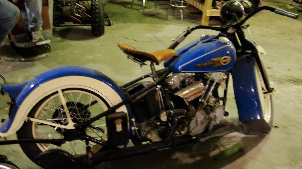

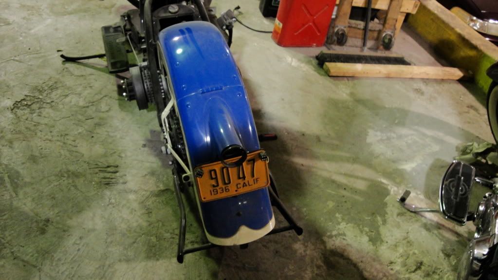

    So i go drop off my car to a family friend who owns a bike shop/antique car body shop and here are the pics of one of the many bikes he had....
    This is how i dropped her off, getting her back on Wednesday
    Now to the bike

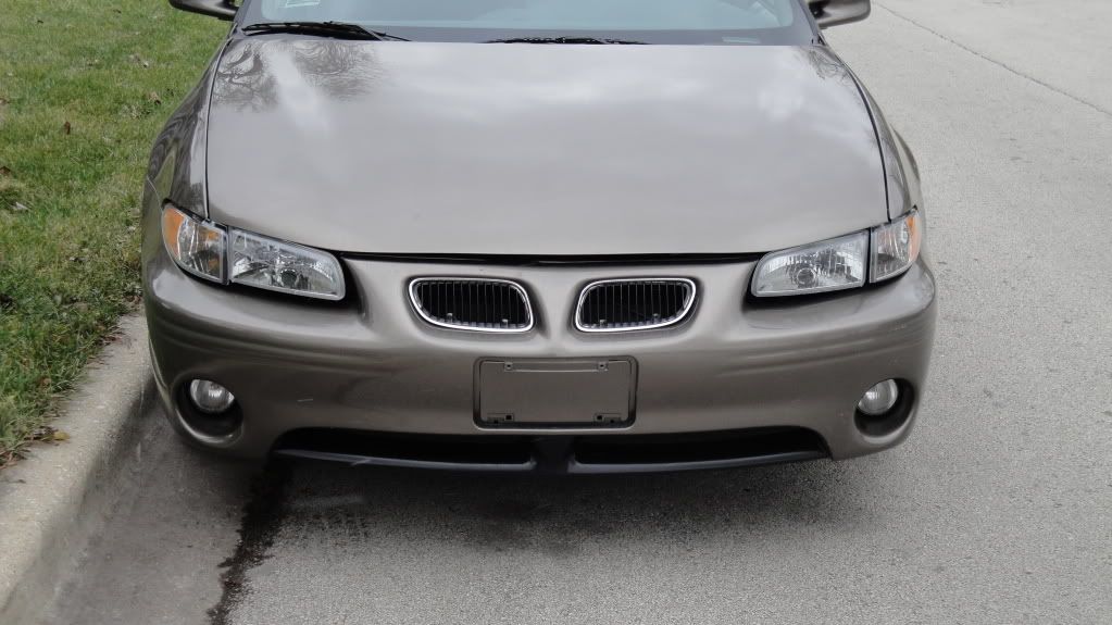

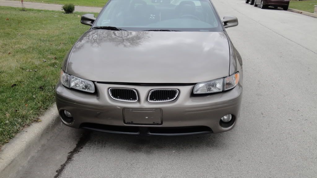

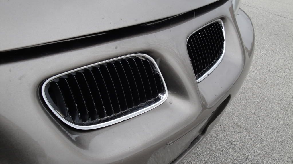

    taking a look at the pics: they look a little rough but thats not what the car really looks like. i have to blow out some of the dust from the sanding. and the reason the hood and the bumper are so seperated is because there is a piece missing, once i pick it up, the gap will be gone, also gonna get the inserts for the rear fascia, and while the rear fascia looks a little sloppy, it isnt, there is just water in the crack
    so i got my car back and posting pics:

    Looks good! were did u get the grill insert? and u should have had them fix the trunk rust?

    they guy who did it is going to be doing some more work on it, im going to have the back end of the car re-sprayed too. i also got keyed on my rear passanger door, he's gonna do some more body work on her, and once i buy the parts, he's gonna put in the hid aswell.
    grille inserts i got from ebay, they are made by alfa otto (i think thats how its spelled)

    What's up with them putting your hood on crooked? It's not lining up in the front and you can tell from the first pic there is little gap on the pass side and too much drivers.

    the whole passanger side needs to be done. i have to get a new wheel well for that side. due to a previous accident (the person i got it from got into an accident before me)

    Ive always said that with huge one piece bumpers everything from the windshield forward will need to be aligned! A popsicle stick is your friend or a plastic putty knife to set panel gaps. Moving the fenders isnt really that hard and once you do that the hood bumper and headlights will fit a million times better. Also bend up the crappy thin metal that holds the top of the bumper right below the hood to close the gap. The hood latch sits on a bar in front of the radiator that can be moved up and down also. Trust me ive owned 3 Gps this body style and have hit my share of deer. Paint looks great just fix the gaps

    the no badge indent on the bumper means its not an OEM bumper! just sayin...
