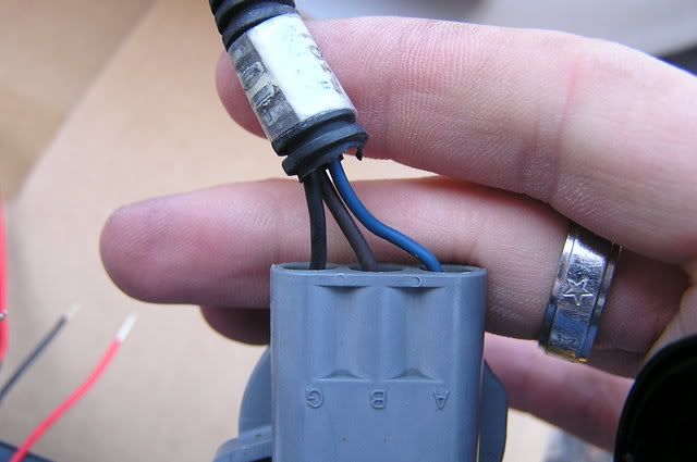

    Your turn signal (big orange bulb) has three wires going to it. The black wire is the ground. The brown wire is always on whenever the parking lights or headlights are on. The blue wire flashes with the turn signal. If you don't want your halos to flash with your turn signal, wire them into the black and brown wires.
    Here's what the harness looks like (pic borrowed from another thread):
