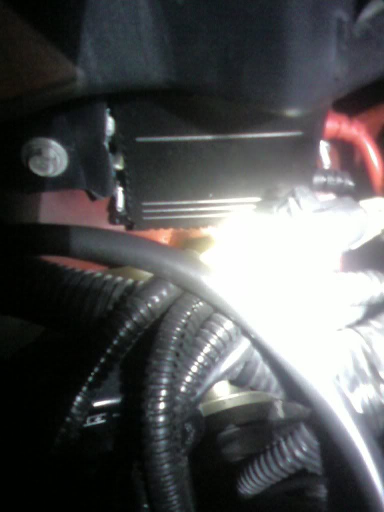

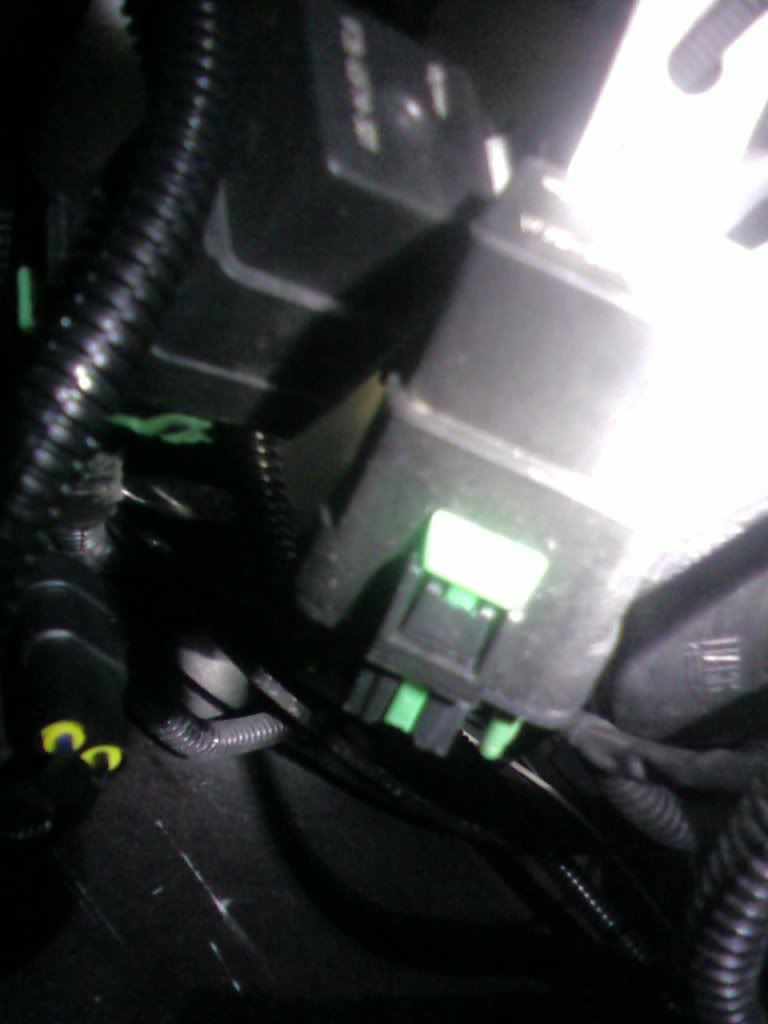

    Since I have a GXP my stock fogs are H11's, how is this relevant? It's not. Anyway, I made a custom relay harness for my HID fogs using AC Delco weatherproof relays. One relay is for the HID's in the fogs and the other relay is for the driving lights behind my grill. I made the wiring harnesses myself so everything is crimped, soldered and heat-shrinked and the fuse holder and relays are water-tight.

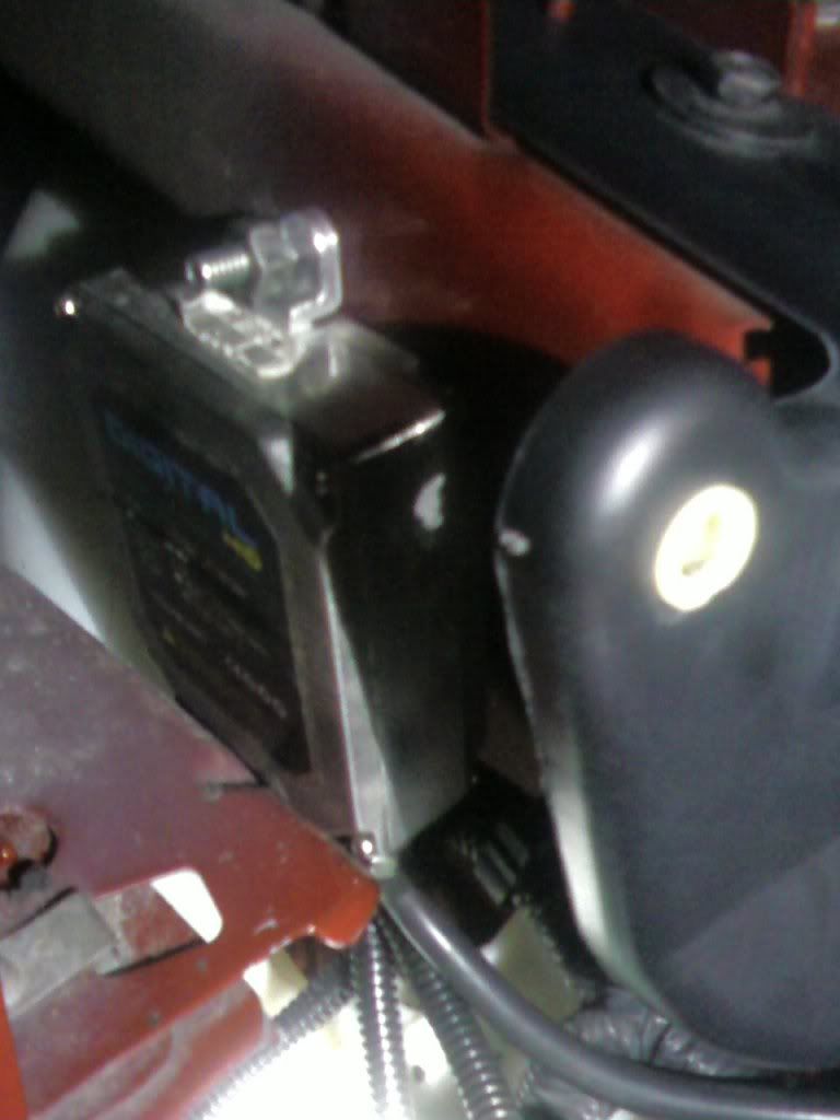

    I mounted the ballasts for the fogs underneath the headlights and used the stock 10mm bolt that holds the headlight holder (piece of black plastic that both headlights slide into) in place, very convenient.
    I got lazy and did NOT use a relay harness for the headlight HID's. I have a lifetime warranty on these ballasts and they're meant for plug-and-play so it won't kill me though I DO RECOMMEND ALWAYS USING A RELAY HARNESS FOR HID'S. Do what I say and not as I do. Anyway, I mounted those ballasts in the fenderwell, again a conveniently available hole helped matters a lot.

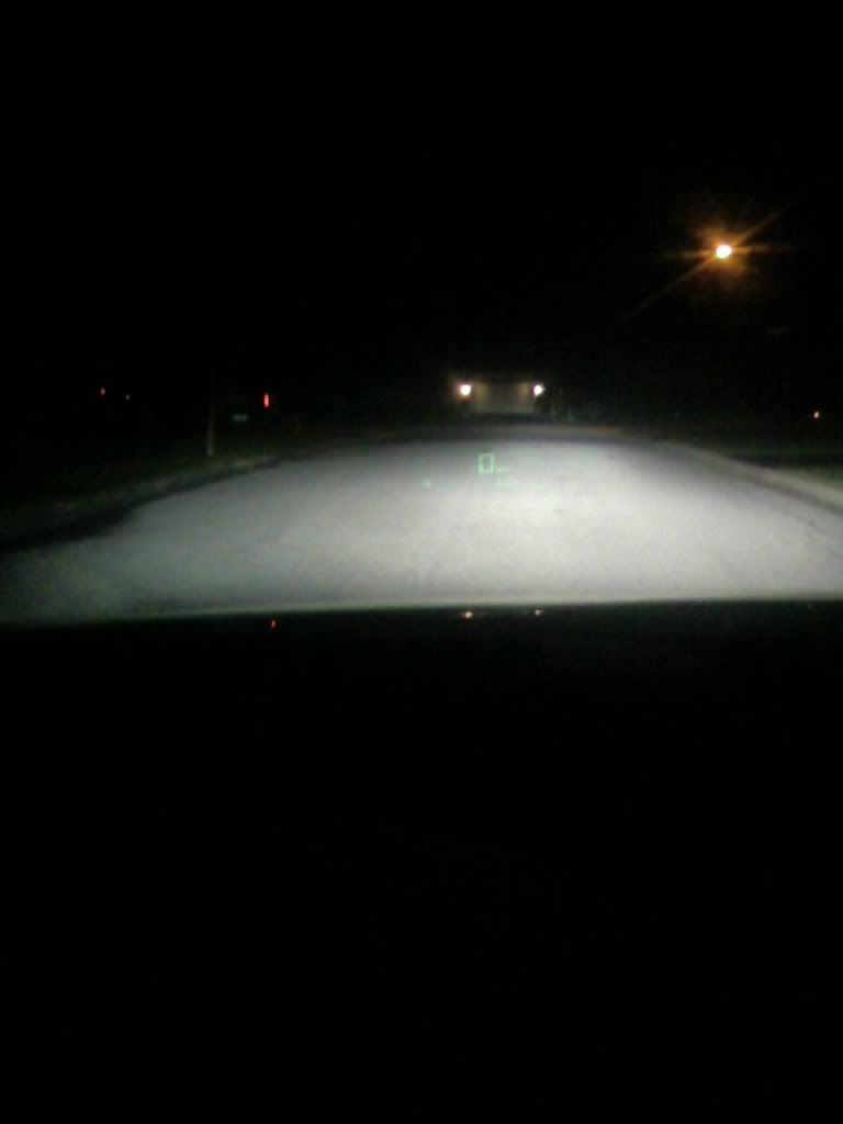

    The results, headlights only:

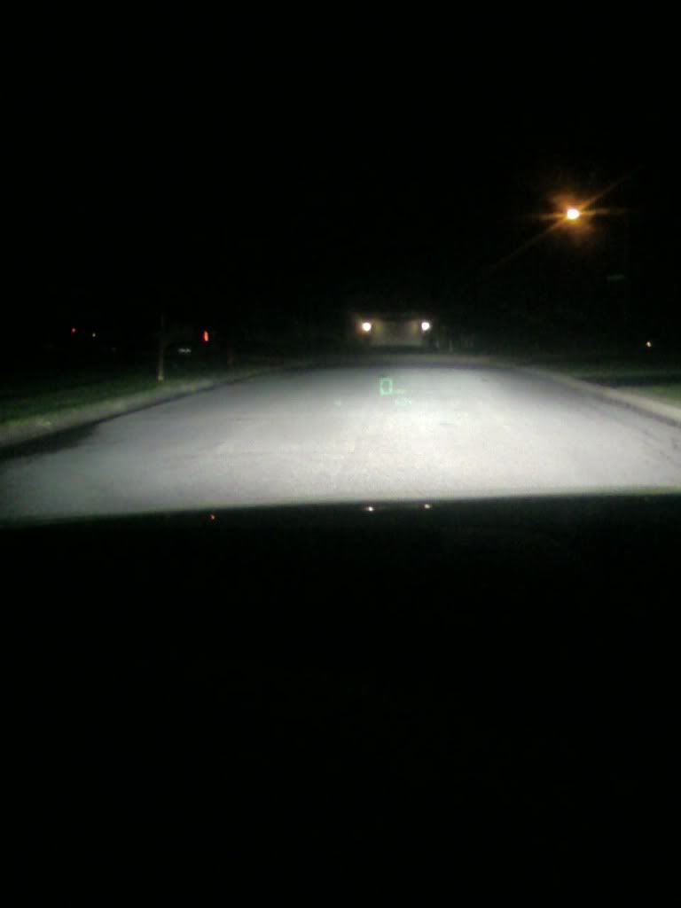

    Headlights with foglights:
