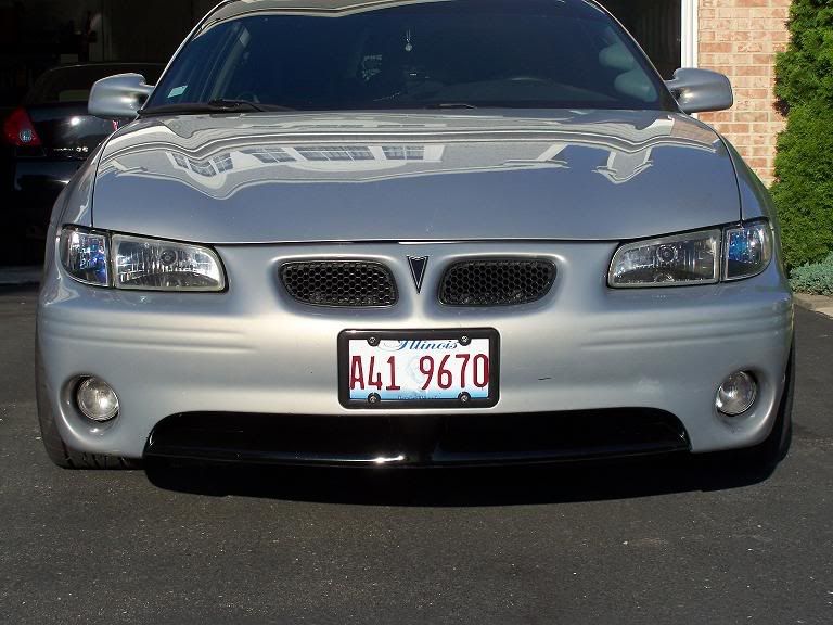

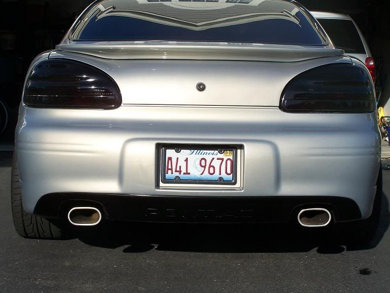

    i can of clear, i can of automotive clear 8$, 320 dry sand paper 4$, 2000 grit wet sand paper 4$....the results....

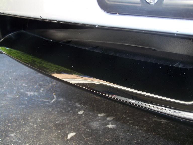

    after the paint and clear dried, i wet sanded with 2000 grit then buffed the shine back with 3M rubbing compound and polish...lil dusty still and still shinier than the factory gloss

    Nice look. Ur car literally looks exactly like mine. Its silver,I've got new headlight and clear corners,tinted tails. On diff is I got gtx tips. I'm gonna do this to my car. Love it. What's the name of the color u used? Just semigloss black or what?

    just automotive gloss black by duplicolor....sand the original surface with 320 grit....makre sure your clean all the dust off and tape it real good take your time taping....then paint...clear. let it dry over night, then come back and wet sand with 1000 then 2000 grit and then buff the **** out of it with a buffing wheel and a good polishing compound...
