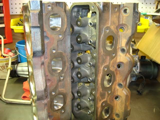

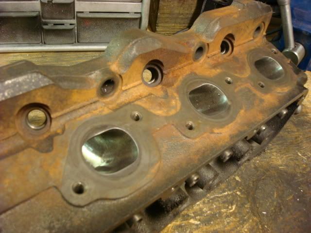

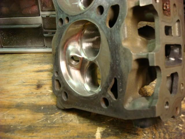

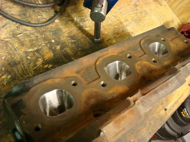

    Here are a few pics of some heads I am working on now. The exhaust ports are ported for the most port to what type of manifold/header combo you have. These are for pacesetter or Tog Extreme headers which have 1 3/4" primary tubes. Porting the exhaust port too much will hurt low end torque and also your header tube becomes a restriction so the large end of the port becomes a lazy airflow area. I have found over the year that keeping these sizes close to the exhaust helps out, keeping the outlet of the exhaust port smaller gives the airflow a lip to catch on for anti-reversion and helps with airflow velocity. Here are the pics......

    I think Im going to barf. I want a machine shop and your skills. Those look really nice.

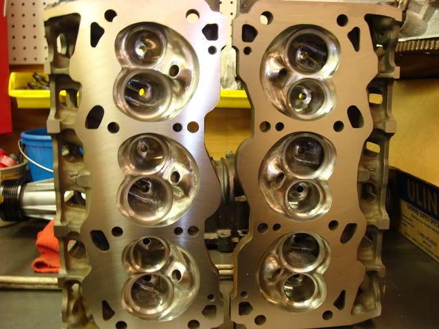

    Here are a few more pics of the heads, these are pics after they came back from the machine shop ready to assemble

    those are beautiful!! don't forget to paint them black color and the rest of parts i requested to have them paint BLACK
