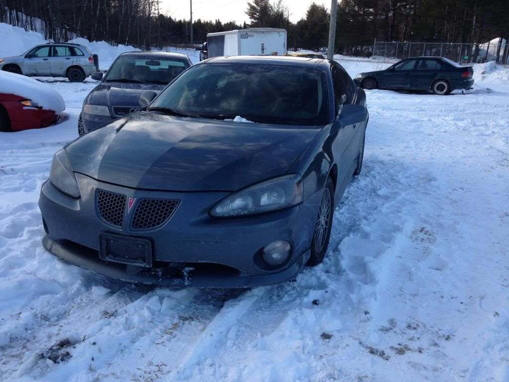

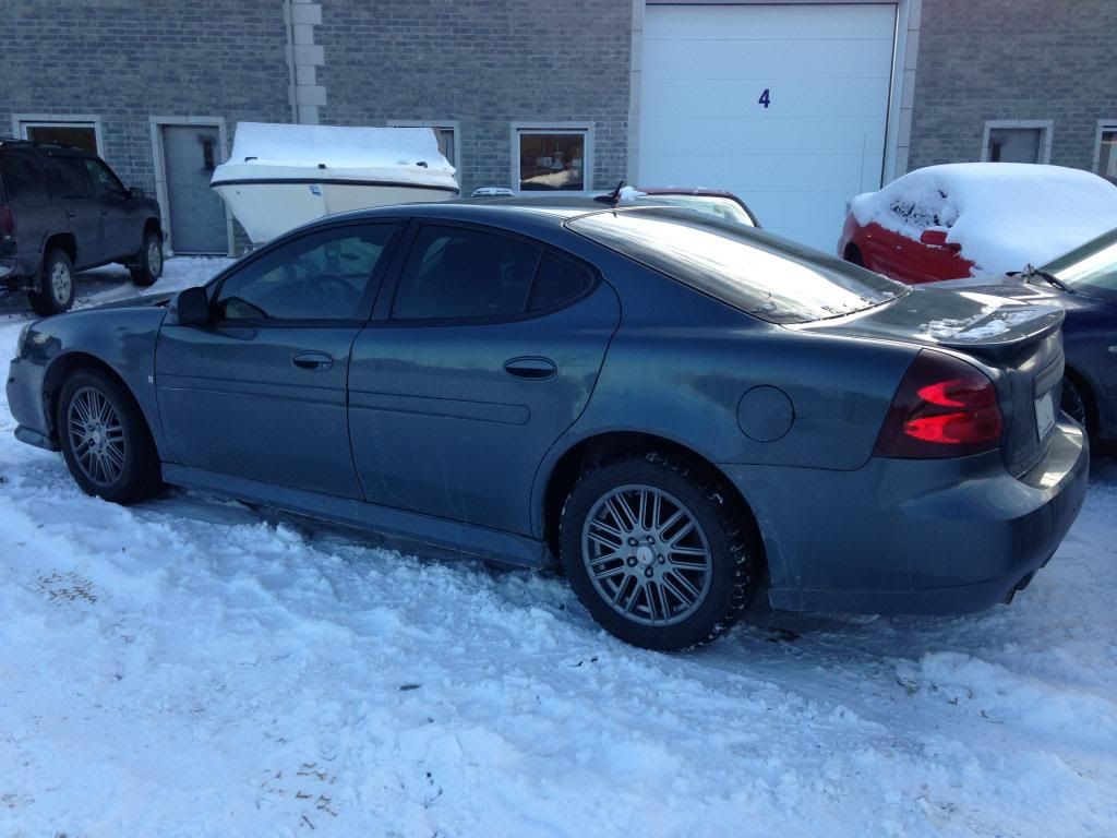

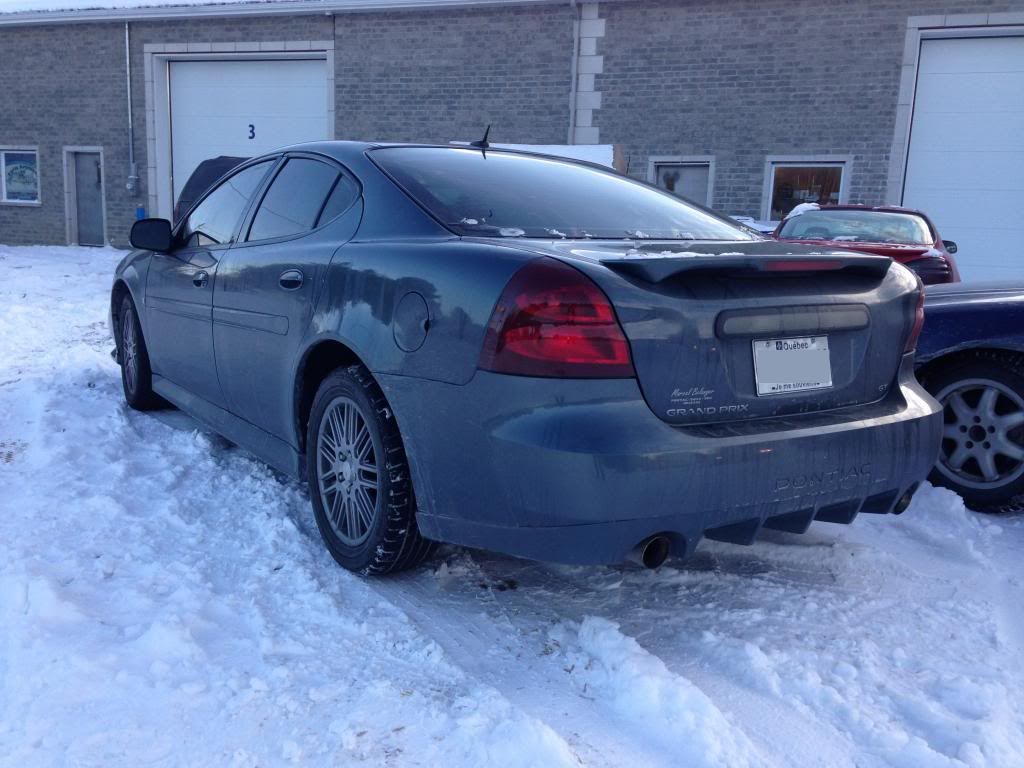

    Yeah, I love it, I think it's georgous inside and out. The photos don't do justice, that color is very nice in the sun and I love the ground effect and rear air damn.
    It's almost exotic looking from the back.
