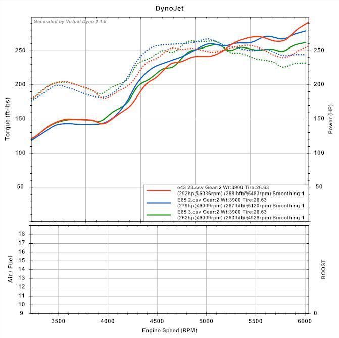

    Anyone use this before? At first i thought it would be good for tuning to see if you gained power, but after doing back to back to back runs without changing anything...well ill let the picture talk for itself.
    But heres a comparison between me before and after E85, holy crap lol.
    These guys seem to think its accurate

    Well you dont really want to do it in any other gear than 2nd, and i think it does account for drag somehow since its listed. My only problem is i dont know the weight of the car so i just put in 3700 + 200lb driver. This was also on a very flat nebraska road. I have also checked my HUD speedo vs one of those radar speed signs and its pretty spot on.
    Its really more of a toy or a comparison for big mods, i.e. changing power adder, maybe cam or something. If you put it on 0 smoothing it just looks awful. Thats why i did 3 back to back runs to see how consistent it was, but whos to say that wasnt just my car.

    In that link, those guys have been within 5 hp on multiple cars. I think one of the reasons for the variance in my runs were that all of them were done on different stretches of road. They are on the same road, just one going one way, one going the same way about 1/8 mile down, and one going the opposite way.

    Thanks for registering bbarnhill. Is there any way to get the dyno to have more data points? it seems to have maybe half or less of the data points that i got from HPTuners.
    Also, as i said i did 3 runs back to back and got a somewhat wide variance in HP (these were not on the exact same stretch of road, but the same road) what else could cause this? maybe i should try doing it on the same stretch of road 3 times. It would probably help if i was on smoothing 2. Im also wondering where you got the drag coefficients and weights from, because IMO 3450 seems low for a GP.

    It trims the data rate to about 1 sample per 100 rpm so its RPM based not time based.
    Any difference in road can show differences in power. Id repeat comparable tests on the same stretch of road.

    No smoothing:
    Smoothing factor of 1:
    Smoothing factor of 10:
    Remember the car made 267.
    I can provide screen shots of the vehicle speed curve which clearly shows acceleration falls off near the top of the gear as you would expect for a car with an M90 and rockers. This also suggests torque is falling off, yet this program suggests the opposite.
    Here are the same graphs with third gear pulls as well:
    If all you're looking for is change in performance, just calculate average acceleration.
    Also which tire diameter is this thing supposed to use? Actual or theoretical? Doesn't specify and automatically selects theoretical.
