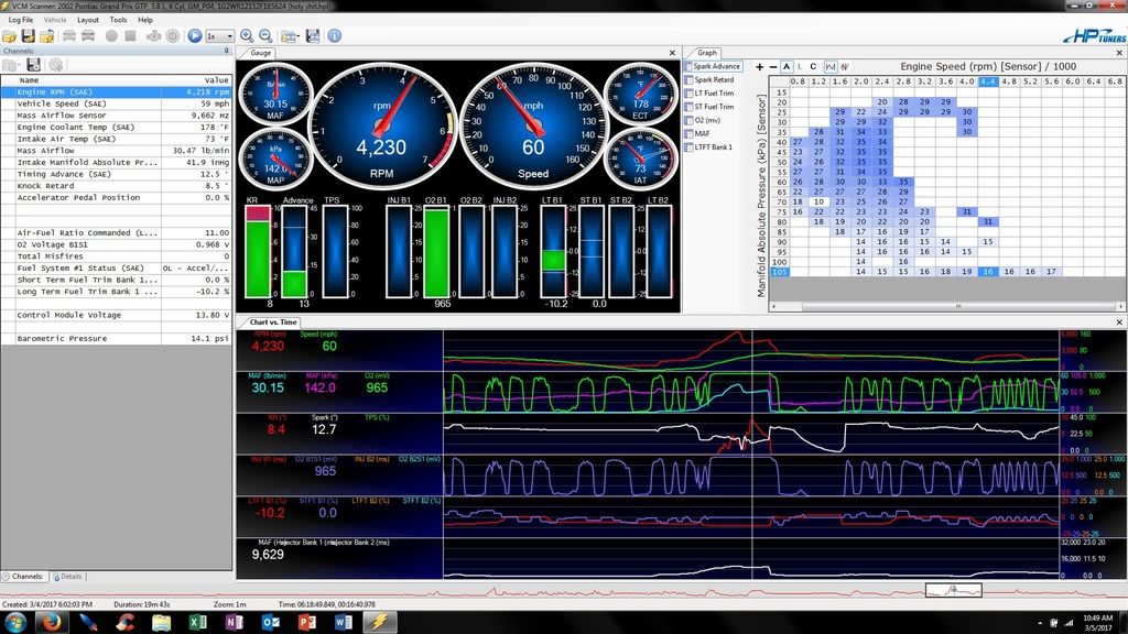

    what rpm does the kr start at? does it keep building as rpm's rise?
    I apologize for my graph layout I know it terrible lol haven't got to organizing it.

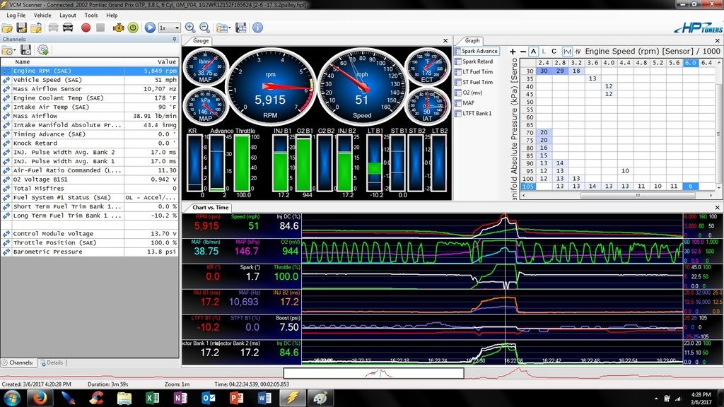

    dont hpt have a simple log to read with out all the fancy BS? i know everyone hates on dhp and its old barbaric set up, but damn, i can read this and know what im looking at.

    I added my inj pulse width and leaned it out like you guys said looks much better. How high do these inj go? 20ms is what comes to mind but this is with my 3.4 on once I go to my 3.2 again it will probably be close. Also any comments on why my MAF is topping out at 10,500 ish doesn't matter if I have a 3.2 or a 3.4 on seems to be metering the same amount of air. I figured i was ok till 11,500

    in the pic i posted, the "injector pw" column see its in the 16,000 range wot top of the rpm's. those are the 42's, stock that value was up to 24,000, and thats maxed out. over 20,000 or close to it is max im told reading a dhp scan. all i know is your maxing them out from personal experience.

    you are still -9 ltft at wot, need to subtract 9% more fuel at that maf hz range. if you add the duty cycle pid to the chart you can see exactly how much headroom you have with your injectors. your o2 mv is at 938 which is getting better, I think 925 is where you want it.

    Duty cycle is a math, there is no channel for it. It appears when you log injector pulse width.
    You have to add it to your charts to see it. You had it there in the first log but were not logging injector pulse width but in that last screen shot it was missing. In the default layout it's in the top with rpm and vehicle speed.

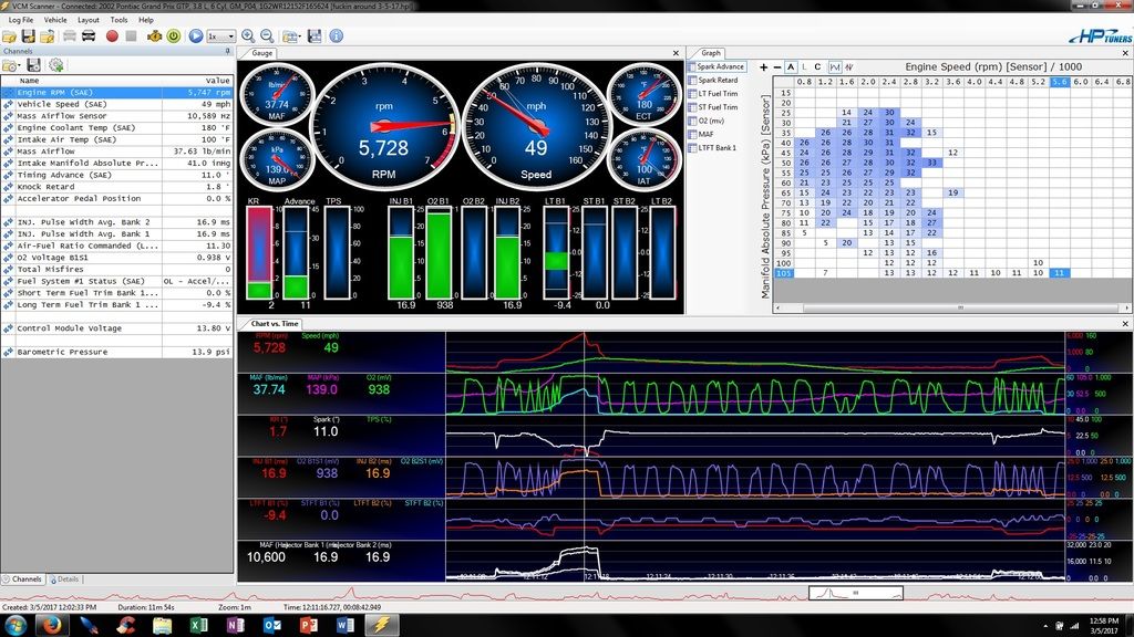

    Ok I added inj duty cycle, and now am hitting 11.5 in PE mode (per wideband). I cleaned my charts up hopefully that helps. This is with my 3.2 back on.
