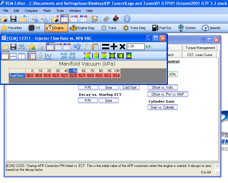

It does look like they are 50's.
Here's a table that should get it running well if they are 50's.
http://i156.photobucket.com/albums/t...psjepcbufy.png

So they are 50s flowing at 45.2 and 45.3? I did read somewhere that it was common for these to be flow a little less than they're rated

So what do you think I should enter in for flow rate vs kpa for these 50lb injectors? They have 45.2 on 3 of them and 45.3 etched into the other 3.. also do any of you guys know what the other 3 digit number on them are? It's different on each injector. You can see one in the picture at the beginning of the post. I'm sorry for all the questions, but I'm just starting.
Re: Injector data question?!
you seem to lack tuning know how. you can adjust them to make them right no matter the size. you would tune them off your long term fuel trims. and maf kpa and change them as need be till the fueling is right.
so load up the 42 file and if need be turn them up, you'll know asap cause you'll be lean if they are larger then 42's.
