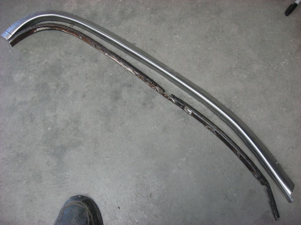

Oh. The one that has little steps out at the end... got sliced and welded to make the steps. There was some hammer action with it in the vise there too. Forgot to say that.
