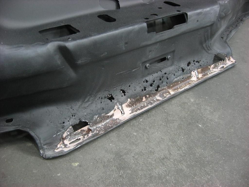

Tim, stand by for another massive a patch pic dump. About that 60 Biscayne trunk lid. Its a Lulu.

next weeks episode?
I gotta see how you get that blended.

Yeah next weekishness. The upper silver line in this pic shows how the contour conveniently goes flat straight across just below the lock. Thats where the splice will be. It was best to let that excess overlap and float until I nailed down the bottom part.The jagged stuff you see around the edge and back just hasn't been fully folded around yet. I had to patch the shell first, as you can kinda see. It was a rough week (sick) and I spaced getting pics of the touchy part when I made that piece. The clue to the sorcery is... make it with posterboard and scissors before metal!
http://i878.photobucket.com/albums/a...psz7hyca43.jpg
It will look just like original when done, with the exception of a couple small details inside the back of the lid. After I hammer the skin around and tack up the splits on the inside edge, the lid will be able to shut those last few mms and I can make it do whatever if its not perfect. The screws are thru slotted holes so I could fine tune the side to side of the outer skin patch. Those holes will all go away when I take the patch off and prep it for final installation. It is awesome to be at a point where nobody questions my methods because I never know if I'm doing it right. Like I always say, I'm a better grinder than welder. Theres just not any of these old lids left still good, and no repops. So we fix.

Oh and see the green chunx? Rat poison. Dammit I did not recognize it as that, thought it was bondo that went through holes. Might have a bit to do with me feeling so rough lately because I handled that stuff and probably inhaled some as dust.

And to think, once all is said and done nobody will know that you made an entirely new chunk of that trunk lid just by looking at it.
