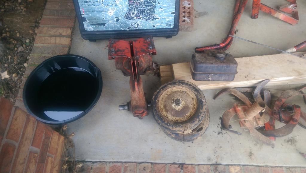

What ever I drained out was some sort of thick diff fluid. Smelled just like it. That rotten smell lol
ever change snout oil?
Yes. This smells worse.

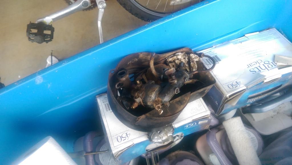

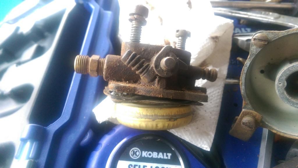

Took the carb apart to start cleaning it up some. So simple.
http://i1272.photobucket.com/albums/...ps9eii30sm.jpg
http://i1272.photobucket.com/albums/...psov1j6wfy.jpg
http://i1272.photobucket.com/albums/...psar57coes.jpg
http://i1272.photobucket.com/albums/...pslvxbiew7.jpg

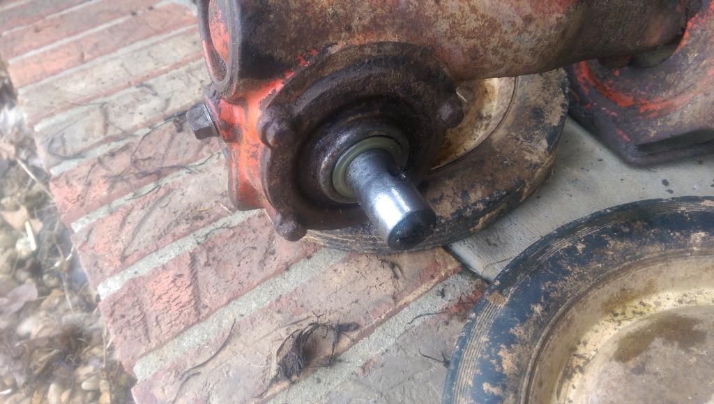

And found out where the leak is. Here's the good side.
http://i1272.photobucket.com/albums/...ps04eordkh.jpg
Leaking side.
http://i1272.photobucket.com/albums/...pspmqwok0a.jpg

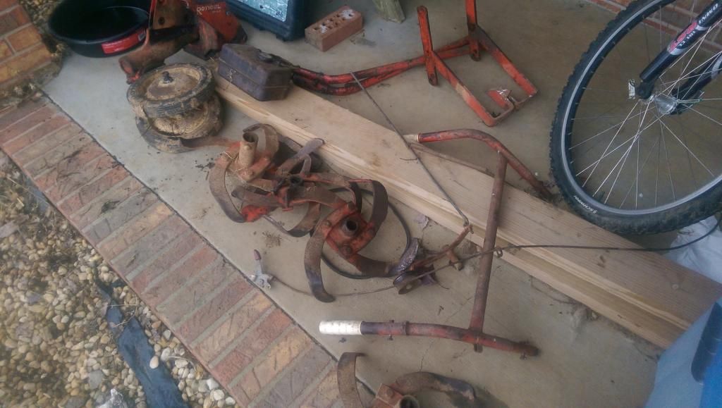

All the pieces I gotta clean and repaint.
http://i1272.photobucket.com/albums/...psmlwf8nw8.jpg
http://i1272.photobucket.com/albums/...psveajfrt2.jpg
http://i1272.photobucket.com/albums/...psbzfpsy6p.jpg

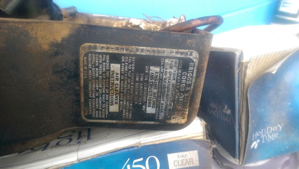

Also gonna return the motor oil I got....found what what it calls for.
http://i1272.photobucket.com/albums/...psdksokrzx.jpg

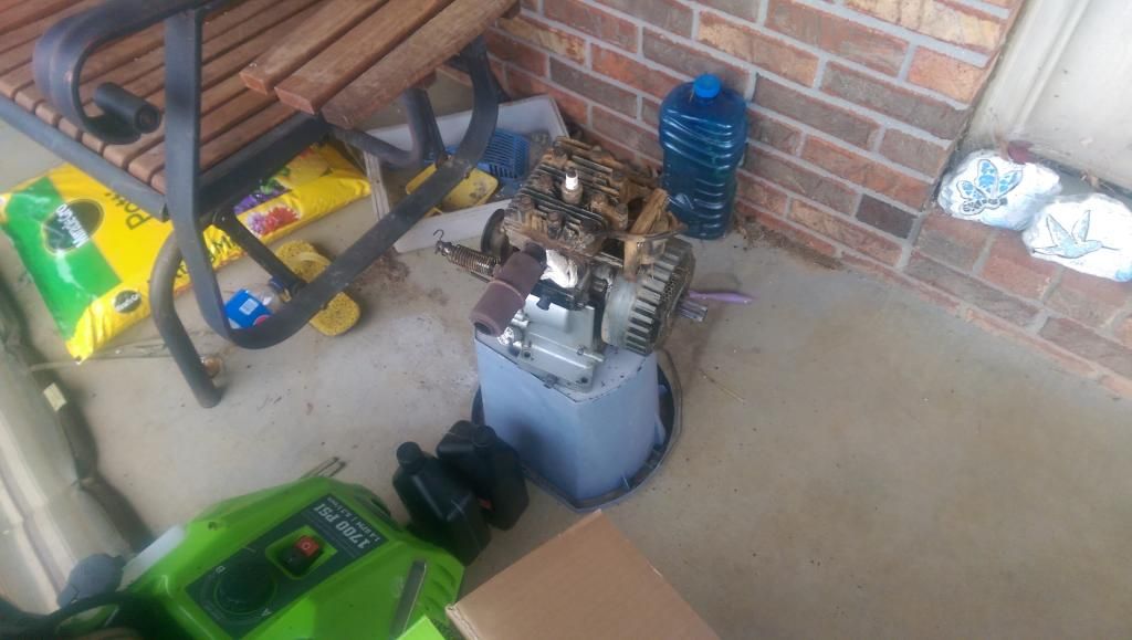

And how the engine sits for now.
http://i1272.photobucket.com/albums/...psjt6e3smh.jpg
now that you got the carb open, theres a pin at the back of the round float, you can push that pin out and the float will come off, under the float is the jet, its clipped to the float near that pin/hinge. take the jet out and spray up that hole clean the jet tip too.
if theres turn screws with springs, turn them in counting the turns, so you know how far to set them when it goes back together, and blow out those holes too, clean the tips of those jet screws too.
when it goes back together make sure the float and jet are hooked up.
Thanks for that info. I'd like to clean the choke to but can't figure out how to get that apart. Sadly for the screws with springs I'm not worried about that at the moment cause it needs some adjusting anyways. Was having problems staying running at low idle last time it was on. I played with the carb some then and got it where it'd idle decently.
the choke id just spray with the body of the carb, its just a flap to cut of incoming air.
the bottom jet screw is the high speed jet. when at full throttle you turn it un till it leans out, then back it back out till its to rich, you'll hear it, then turn back in til you hear it peek out, aka that fat spot.
same for the other screw on the side, only at idle you work that screw, stop where its running strong at idle and goes right to full throttle from idle. if it bogs you need to play a bit more.
welcome to old school tuning lol
