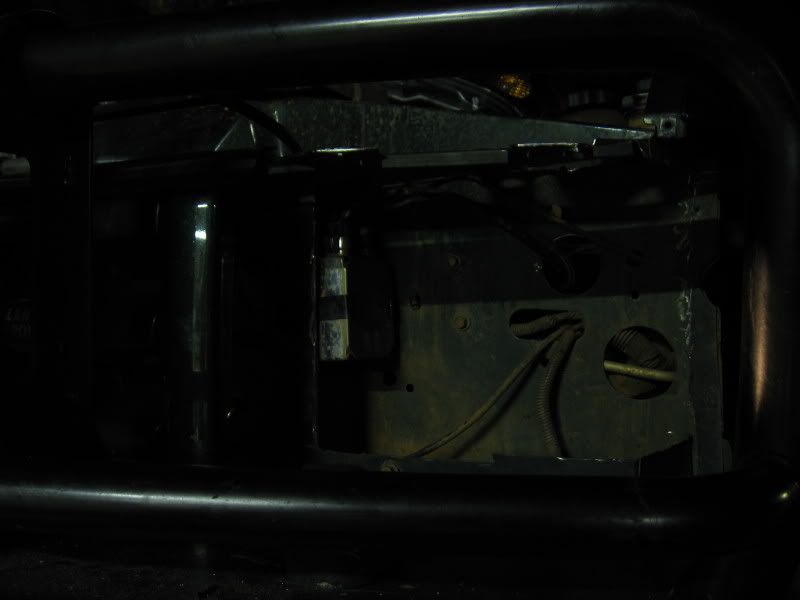

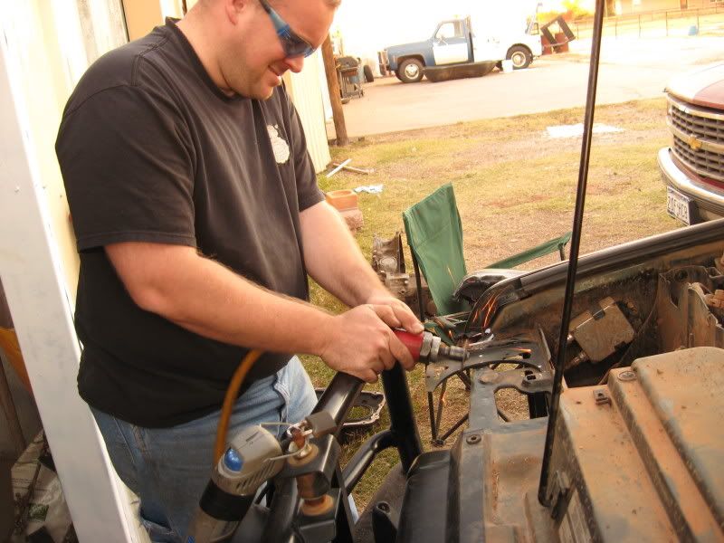

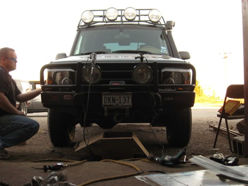

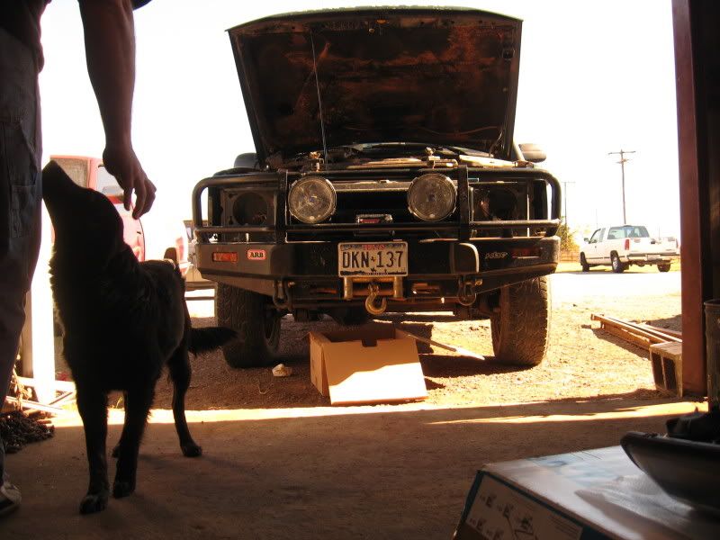

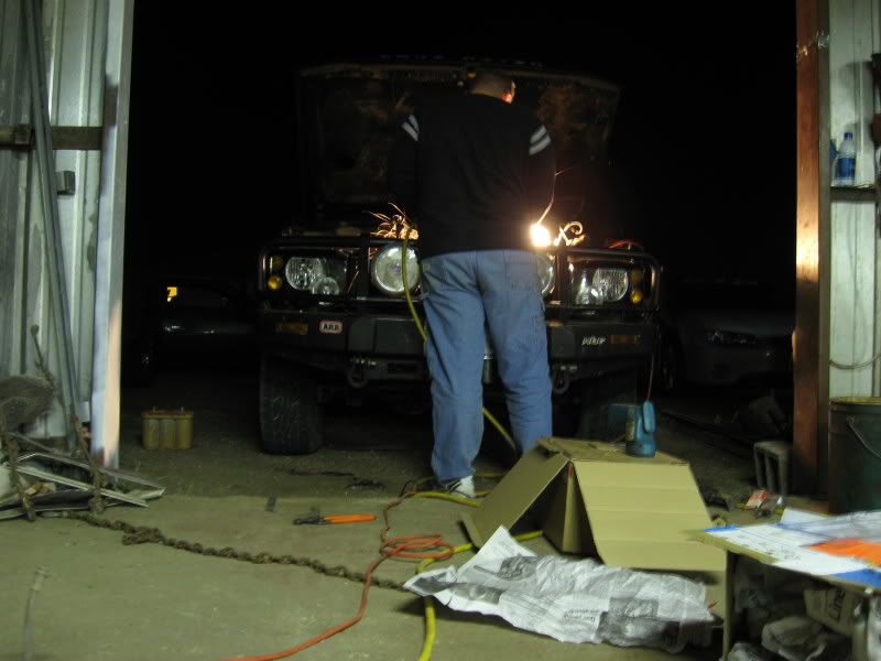

Well today we finally did the task of installing my 03-04 Disco lights in my 2000 Disco. We modified and installed them using the previous existing write up at the beginning and then began to modify things our own way. All in all we have two brackets on each side riveted to the core support and bolted to the top of the headlights, as well as the existing tab mounted on the inner side of the headlight bolted down, and a bolt going into the fender through the tap out the bottom outer edges of the lights. So needless to say it's more than sturdy enough.
The entire install, from turning the truck off to starting it back up took us 6-7 to hours total.
We also reinstalled my HID kit original made for a 9003 bulb into these H7 headlamps as seen below.
Needless to say it was more than worth it.
What do you think? Any questions?
Before-
HID Install/Routing Corner Lights Install/Routing-

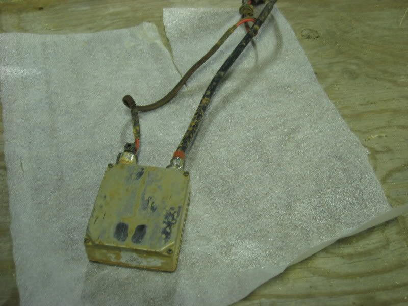

HID Ballast (Yes, they are Durable)-
Test Fitting -
One Upper Mount-
More Fabrication-
HID Ballast Mounted-
DONE-
