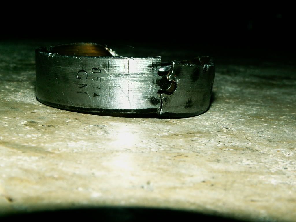

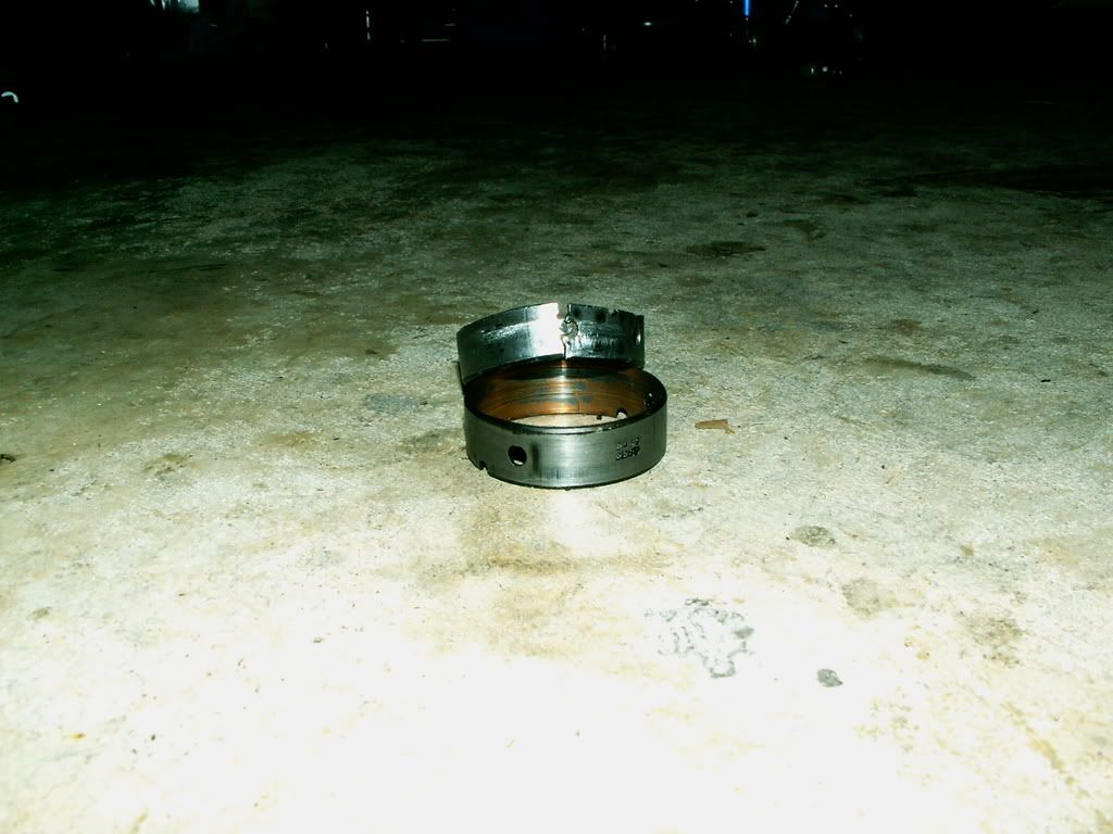

    I took a look at it earlier today and noticed that the bearing is already split across the oiling hole, so I'm going to try and just roll it into a smaller ring around a lobe and try and pull it through like that. I'll update tonight if I get anything accomplished. I may not since I work until 10pm

    Well, I have both good and bad news from my work so far today.
    Good: I got the cam and FUBAR'd bearing out of the block and the oil pan dropped.
    Bad: I have no clue where my third bearing from the front is...(edit: NVM, found it neatly perched on top of the #3 rod.)

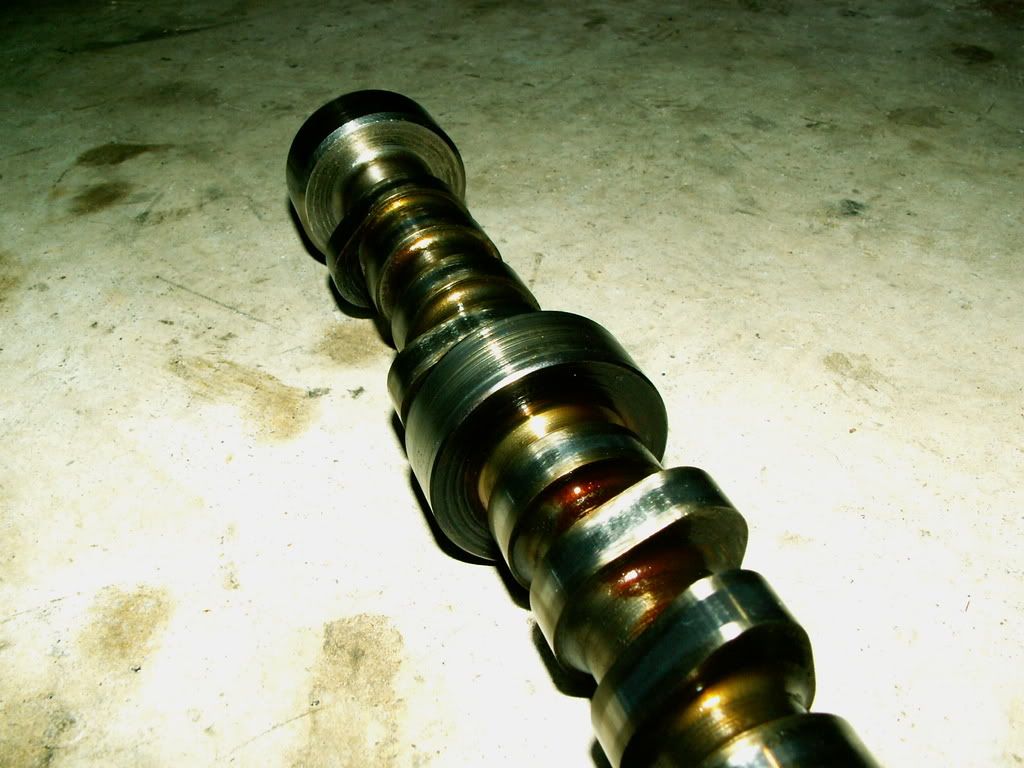

    I had to stretch the bearing open and pop it off of the cam. I bent it back close to round to show about how it looked before I removed it. Also, the rough scratches on the outside of the bearing are from me using a screwdriver and pliers to get it spread apart and off the cam.
    How bad do those score lines on the inner two journals look?

    I just want to say that with my experience around engines i have never seen it a spun cam bearing that allowed for a new cam bearing to be installed on the same block. After reading his post about this i came to following conclusion.
    Source of the knock was the cracked manifold.
    Source of the cam bearings coming out DanGTP.
    Either way he fixed it and made it right but look at the tool marks on cam bearing, they should not be there if it spun. Also, where is the oil pressure light or metal shavings?
    Maybe one day he will come clean and let us know what really happened but it really does not matter anymore b/c he fixed it. I am just playing the odds here and stating my opinion. I am not harping or calling anyone out i am just listing some known realities. Mistakes happen no harm no foul.

    Holy cow dude. Did those bearings get like that as a result of the tear down or were they like that to start with? Ive seen a lot of odd things but never that. Might be a good time to go with some good clevite bearings.

    That first bearing looked pretty much like that already. I introduced some scratches and dings with a screwdriver, but the majority of the damage was done by the car. I guess it's a good thing I already have a new cam to put in since the original one is pretty much useless now.
    Actually, Scotty... I've got a set of Clevite's already headed this way from ZZP!

    I got the bearings in and the cam installed (It went much smoother than I expected). I've got the front cover on and will button up all of the bottom end tomorrow and start on the top end. I have yet to receive my new valve springs, so I believe I'll go ahead and put the heads back together with the stock springs for now and put the new ones on when I get them. Hopefully, assuming I can find all the nuts and bolts and remember where they go, I'll have the car running this weekend. Keep your fingers crossed!
