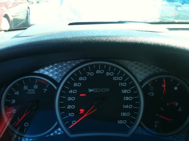

    i already know about the engine. but with everything else like the front and back bumper. would they bolt right up? i have a 2004 gtp right now. also is the speedo plug and play?? the dic is slightly different because it has the tire pressure levels of the tires and the max g-force ratings in a menu also.
    i think thats most of it. cant think of anything else the gxp offers. except the seats and stuff which i know will bolt in..
    but the big thing is the dic and the speedo for the inside if those would work

    Speedo drops right in no problem. I converted the inside of my 04 basically to everything a GXP has on the inside

    thats why i said everything besides the motor swap i want to know about lol. so the 160mph gauges will work with the gtp pcm and stuff? along with the dic with added functions?? those are the 2 big things for the interior i was wondering.

    Speedo is plug and play ^ have one in my gtp. For the front you would need the front end, both front panels and rocker panels.

    seems quite difficult to track down a gxp gauge cluster actually..lol

    I saw one on morad a few weeks ago for like $60. I REALLY wish I would've jumped on it because new ones are like $170, and even most used ones are around $160ish.
    Also, question about the g-force menu. If you just hook up a stock yaw sensor to the DIC would it recognize it and function as a GXP DIC? I ask this because I have the 5 button DIC and it appears to be the same.
