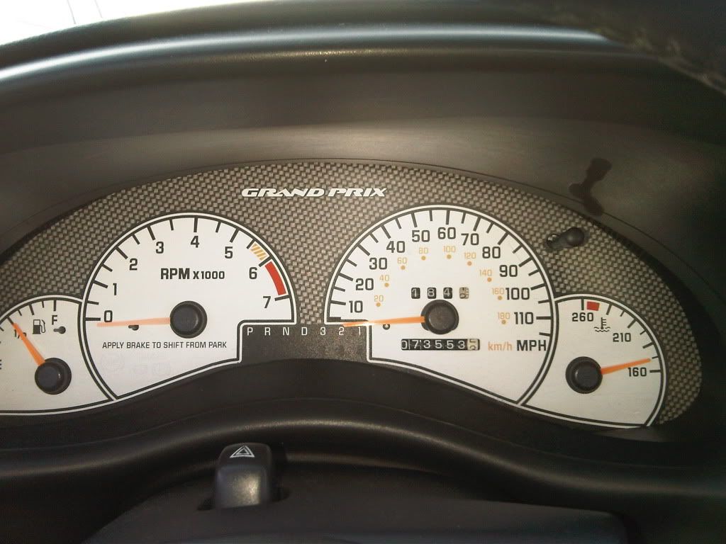

    GTX Level Member 03GTPLE's Avatar
    Tyler, TX
    604
    I have a 2003 Limited Edition cluster that is different from the rest, but it's just the face.
    However, My speedo ticks are only every 5 MPH.
    As far as PERF SHIFT goes, I have a PERF SHIFT slot and it's part of the face. As we know, PERF SHIFT did not come in my car, but I wired it up and activated it in the PCM, and put in a socket and bulb in the cluster. The DIC will turn on, but not the cluster. I'm not sure if that's a change because I've read of other people adding PERF SHIFT and the light coming on in the cluster.
    The 2003 Limited Edition cluster has a carbon fiber background with white face guages. It's really neat and easy to read.

  18. #18 Re: What are?
    2,995
    my cluster:
    hope that helps.
