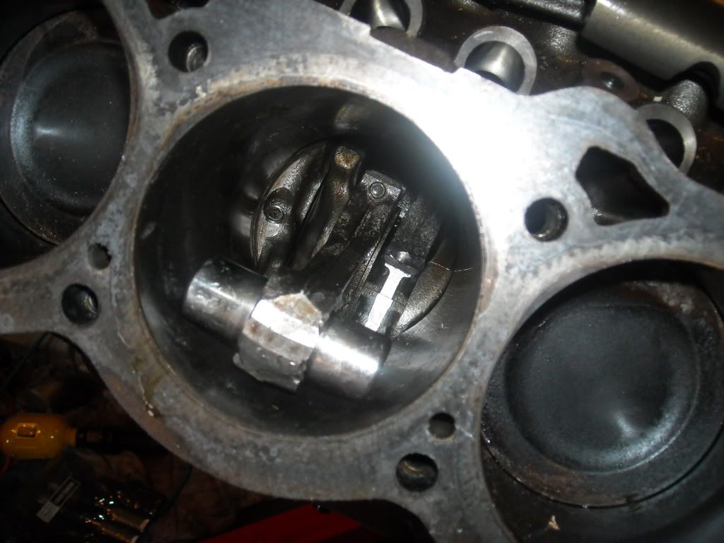

    Motor #1) Lost it to a ZZP PCM (and after FIVE messed up tunes you'd think I would have learned, BUT...being 18...I didn't)...only pic I have of it. Looks like a normal chipped piston...but after we pulled the oil pan it turned out the skirt totally shattered and wrapped the rings around the crank. Awesome. Tried to take the easy way out...

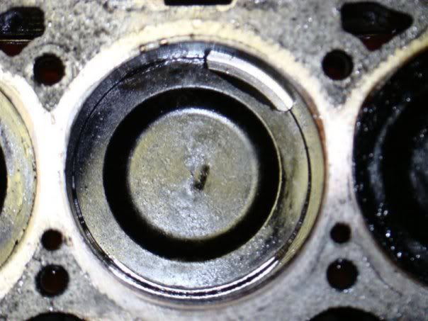

    Motor #2) Bought a low mileage L67 from Morad...pulled the heads off...chipped piston. 1st one he had ever sold like that. Good to his word...had another motor out on the truck the next day.

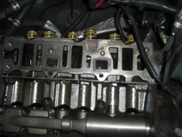

    Motor #3) Lasted nearly 2 years (and went 13.4 on a 3.4", stock throttle body, pump gas, etc.)till a lifter failed since I was shifting around 6500 with the XP setup. Coincidentally, the injector took a crap at the same time...so cylinder #4 leaned out so much it shattered into hundreds of pieces...even had parts of the piston in the header and muffler when taking off the exhaust LOL Best part of the story is that I had lost my bank job earlier that day due to the economy...even more win. See if you can spot the "What Doesn't Belong" in these pics...
    Pushrod ripped through the Head Gasket...

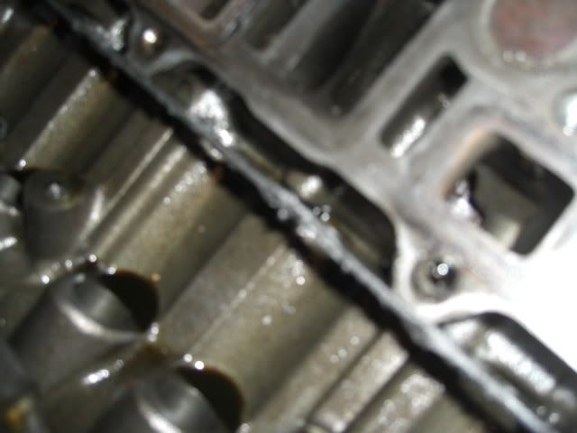

    Looks like a normal LIM right?
    ...How about a closer look...
