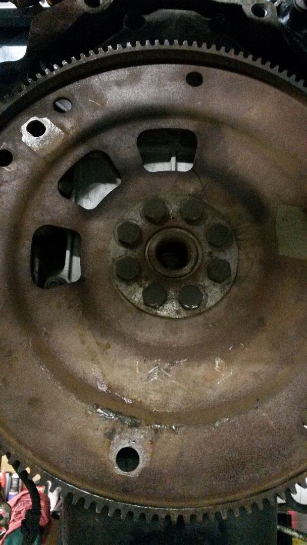

  10. #50 Re: Jrb1027's Blue Beast

    im pretty sure i cracked the flexplate while pulling the trans out
  11. #51 Re: Jrb1027's Blue Beast
    39,929
    it may have been cracked already, and that was the kr?

    yeah.. thats possible but I just had the engine out not too long ago and didnt notice any cracks then

  17. #57 Re: Jrb1027's Blue Beast
    5,418
    sooo it seems im not the only one that destroys flexplates around here!......
    car will be even more fun once that trans is in!!
  18. #58 Re: Jrb1027's Blue Beast
    GT Level Member jrb1027's Avatar
    Jun 2013
    brookville,IN
    454
    Quote Originally Posted by 98BrokeMyCarVet View Post
    Im almost sure I broke the flex plate taking out the trans i thought i had all the bolts out and had a pry bar against the flex plate, see the marks on the flex plate, and the new trans is in it runs great useing a 3000stall at the moment it came with the trans so figured id give it a try.
