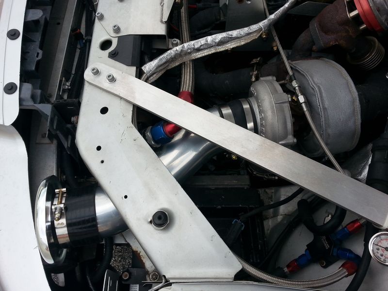

its stunning how the JMB intake tube is able to fit....it does need work, and really some of the sheetmetal above the tube should be removed

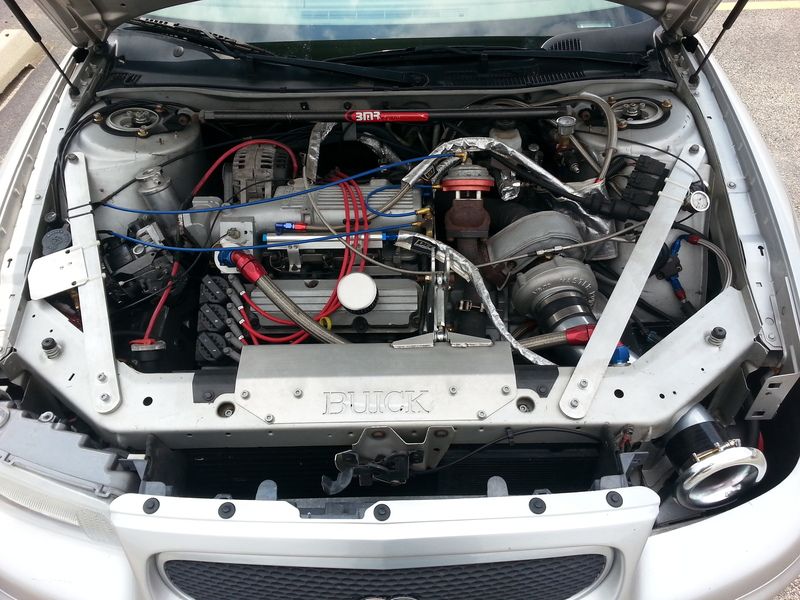

Besides that engine thing distracting me, some sort of modern day art project, how do you have the license plate attached?
two screws right through the cover into the foam support

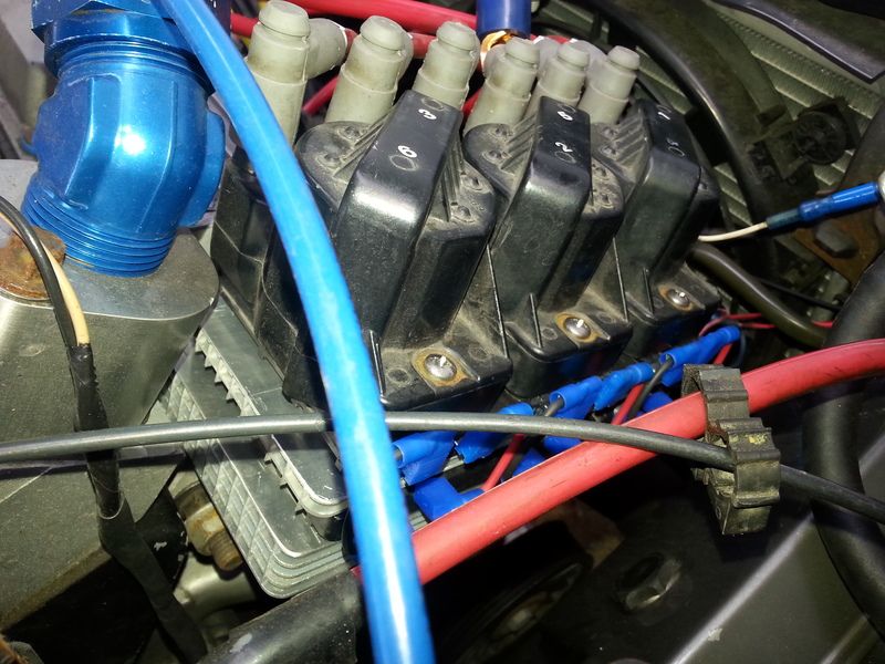

I bolted down the extra tall heat sink base and the dual ICM's.
the ICM seems to be kept from the engine heat, though it ends up at the air temp of the air flowing through the "cool" side fo the radiator
the splitter harness also has an autometer tach driver wired into the ICM's power feed. I now have a good clean tach signal that has excellent resolution down to 400rpm dips.
its also setup to let me kill the slave ICM for back to back dyno tests....lets see if it helps.
we should now have no problem triggering the dyno rpm pickup and be able to make 1500rpm+ pulls so I can see the tq curve as it'll easily climb another 1200-1500rpm on the converter even at that low of an rpm

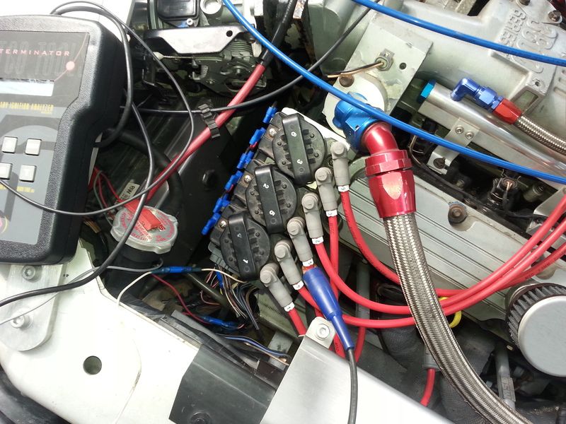

anyways onto the dual ICM's / ICM stacker
idle firing voltage shows a gain of 2-6kv on average
id like to make a plug fixture that would let me check the loaded firing voltage on the positive and negative firing sides.
I think it would be best to run a few ICm's with the dumb coil near plug's mounted to the valvecovers
