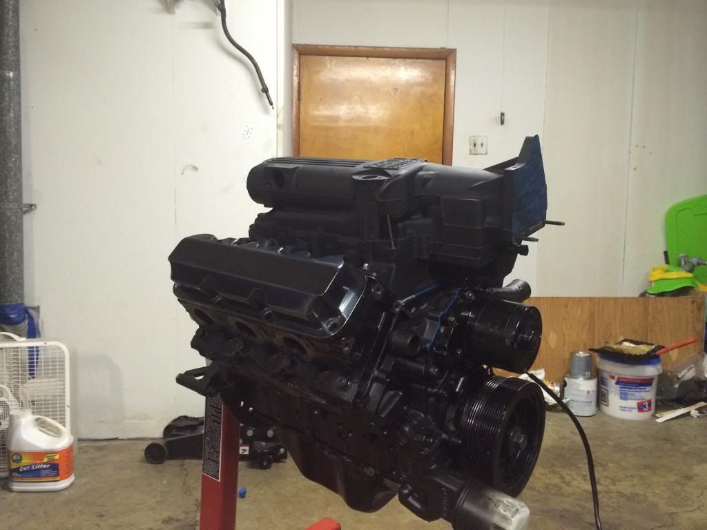

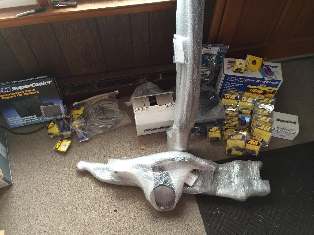

    so i have been buying up parts for this for a while now ill throw a few pictures of stuff up but i have the motor done and 95% of the parts to put the rest of the car together will be diving in soon here are some of the goods i have going in it as of now
    the motor is a low mile l36 with a st5 cam st3 heads 150# springs, electric water pump, sfi balancer, sfi flex, ls7 lifters, custom pushrods, ported fbody intake there is probably more but thats the jist of it

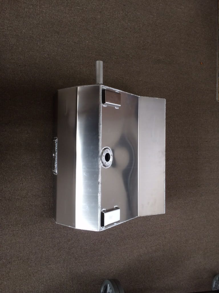

    fuel system is a aluminum stock location sumped fuel cell with -8 lines magnafuel pump and boost refrence regulator aromotive rails and 127# injectors
    the trans rearend set up is a FTI level 4 reverse manual valve body trans brake set up with a custom billet FTI stall, and a dana S60 rear end
    suspension is strange coilovers up front, comp adjustable rear shocks with stock springs, founders performance frame connectors, founders lower control arms and panhard rod, uim torque arm with tunnel brace and drive shaft loop probably some more but i cant remember
    and I just picked up a precision 7275 billet wheel turbo for it the other day

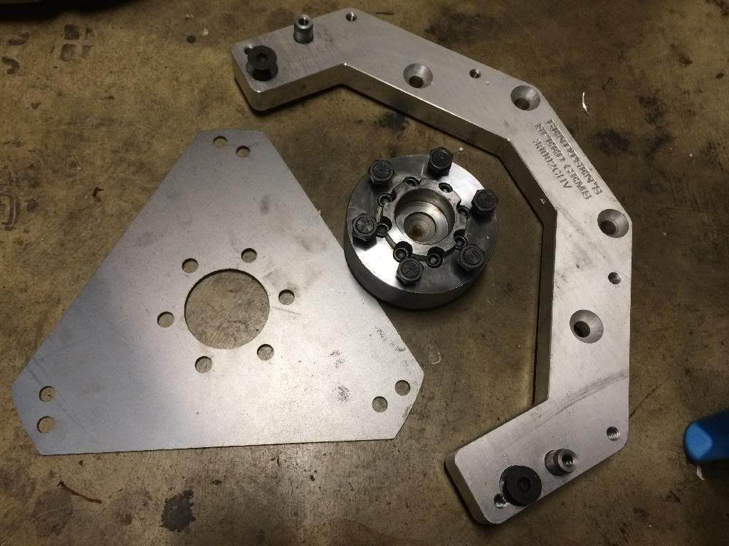

    3800 th400 trans adapter
