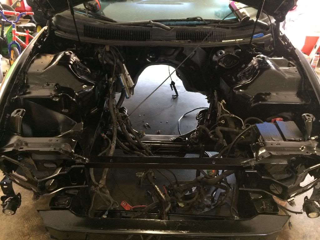

Well, I'm going to try to actually kick the downpipe right out the factory exhaust location...down the D/S and under the trans. I think that's where my big issue will be. I might end up making brackets to mount the A/C compressor right where the it is on the 2.2. I haven't quite figured it out because I need to get stuff together for mock up.

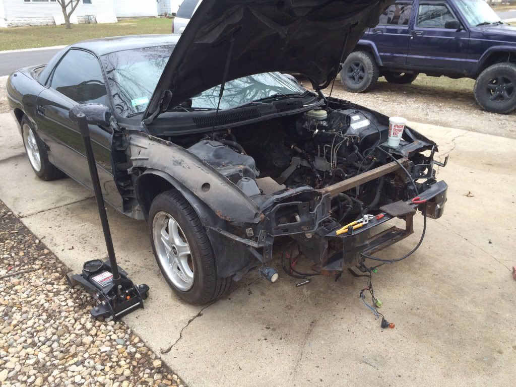

few more things done i plan to start hitting it pretty hard now that the weather is getting nicer

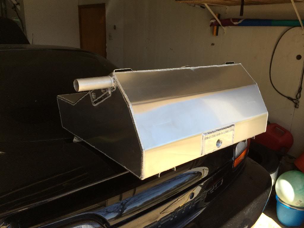

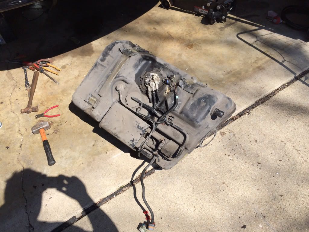

I'll have some more soon, hopefully pulling the fuel tank and stock lines today cleaning up the mounting straps and maybe getting my new fuel cell installed
out with the old in with the new

also i didnt build the tank i had it built for me i cant tig yet

i wont be selling it for quite a while, the nice thing about the camaro is when i get bored i swap the k member and engine harness and hello turbo lsx everything else bolts right up, throw together a new turbo kit buy rails and 2 extra injectors and im back on the road

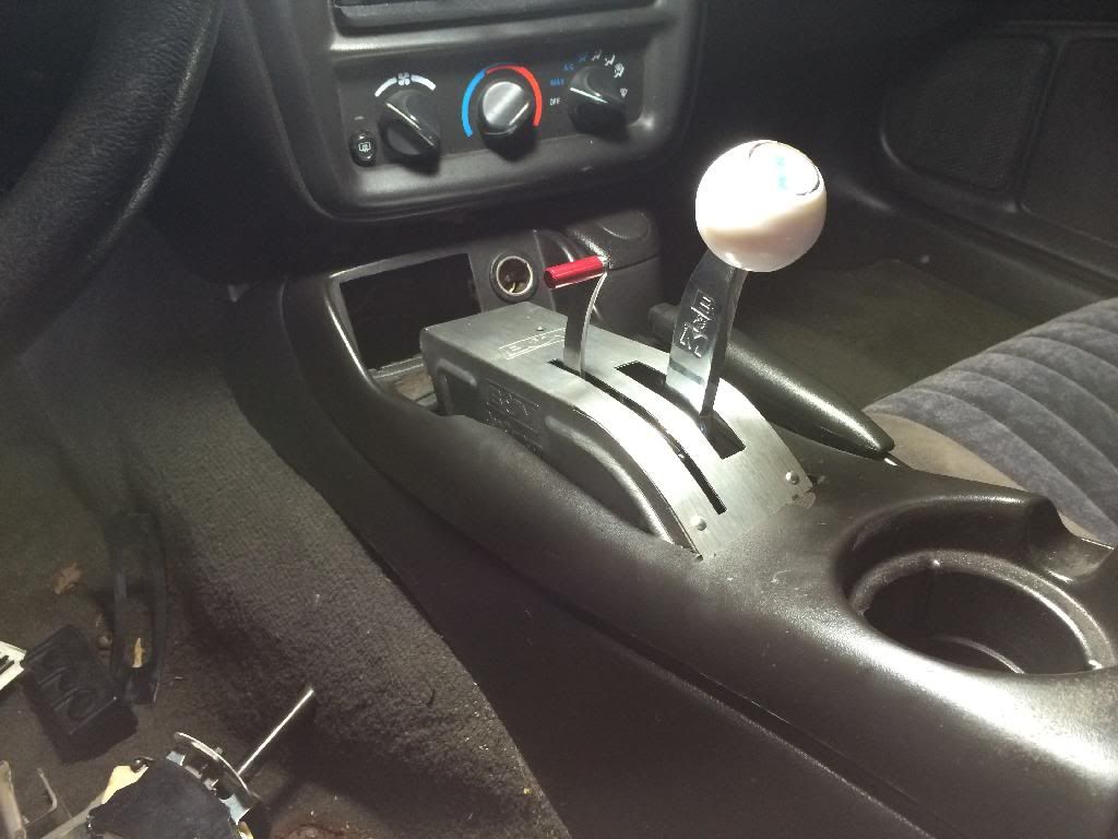

shifter mounted still need some triming

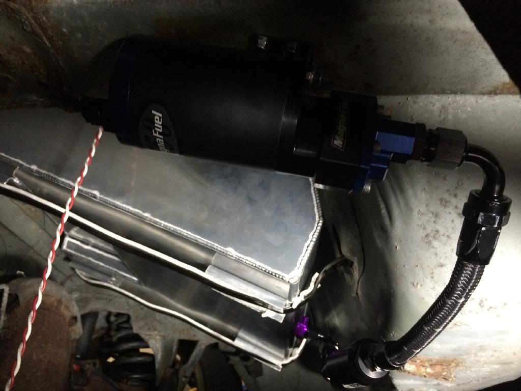

tank and fuel pump mounted and plumbed i still have to run the return im waiting on a couple fittings to come for my regulator

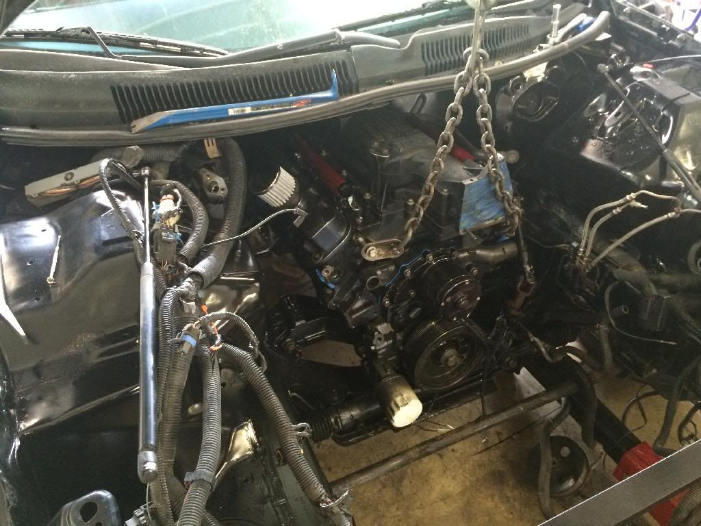

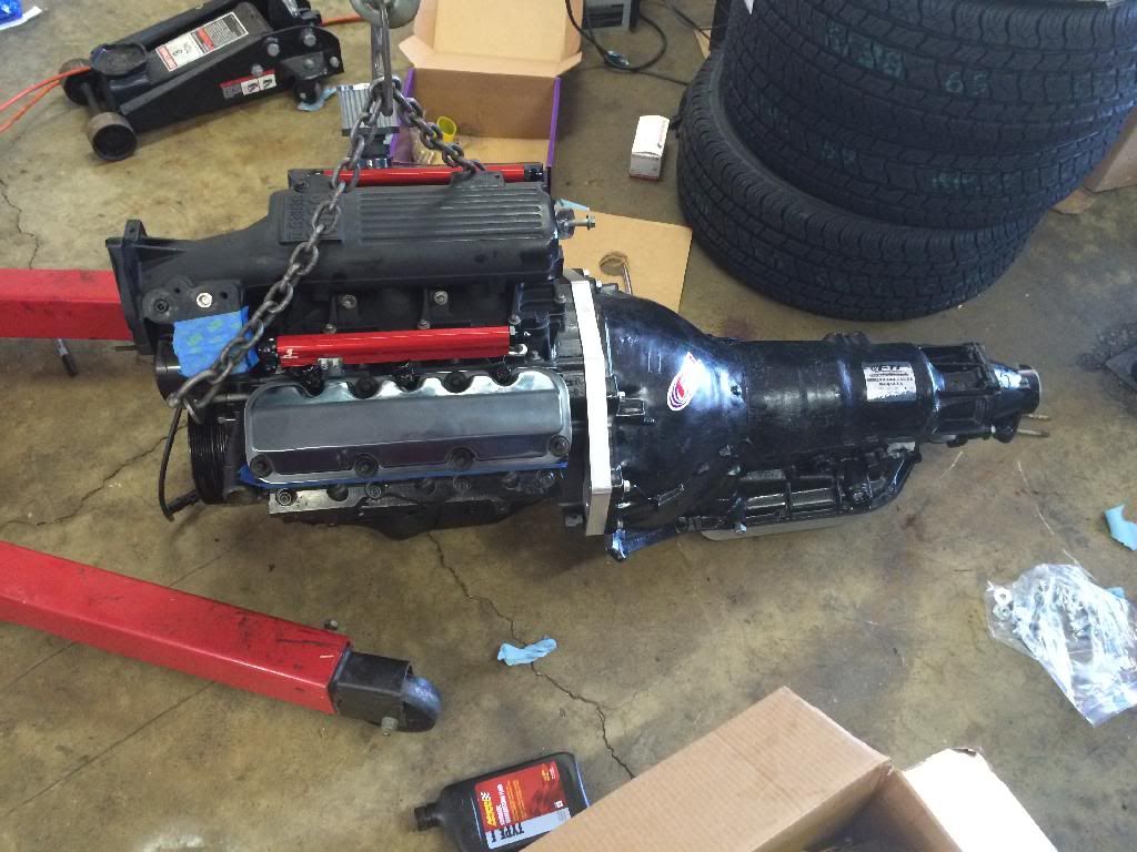

and i set the motor and trans so i know where the rails are going to be exactly to plumb the fuel system, i might just leave it in there i dont think i really need to do anything else to the motor or trans
