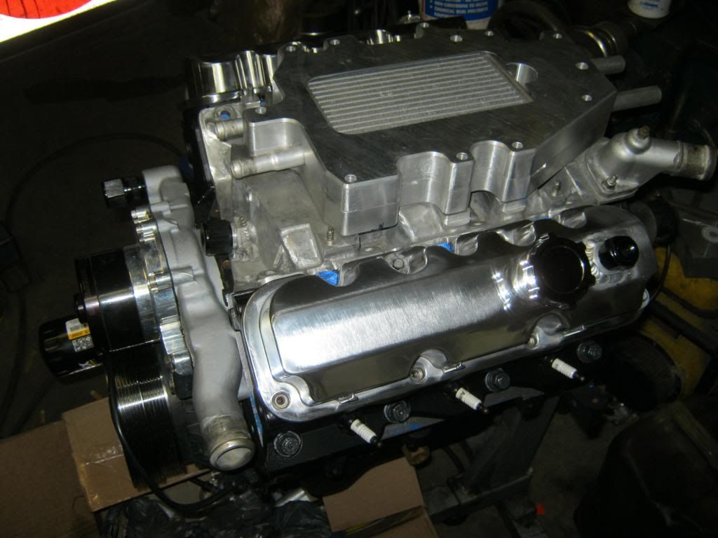

    Dicking around now. Yes I painted the motor cast alum and vc and blower case black. Need to make a bracket for alt then swap the m90 tensioner with a ribbed pulley instead of smooth.
    20170701_153003 by Corey S, on Flickr
    I also discovered by removing the previous owners 4ga power wire the front passenger carpet is damp under neath and the trunk back left pocket was full of water. I am hoping I can attribute this to the crazy ass storms we had not that long ago and the car being about 15" higher in the front................... But she is on her way slowly, driving me nuts.
