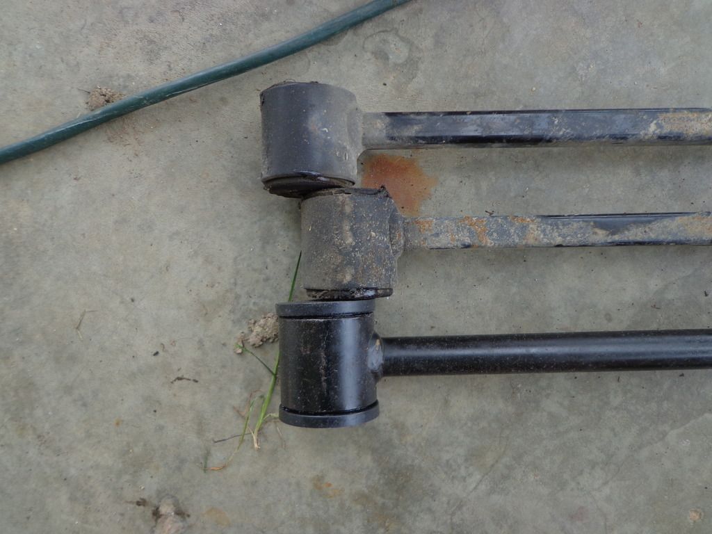

    So it seems like 2 months later, but the trailing arms are going on. Passenger side is done, I just need to put the wheel on but it's lunch time lol. Everything went together pretty easily, just needed to bend trailing arm bracket a little since the poly bushings were a bit wider. Here's some pics, I love this weather and dirt roads. everything was so clean a few months ago:

    They're both in, and on my initial test drive, I'm very happy. I didn't go all that fast, but I could feel a difference trying to whip the ass end around. No noises, and everything went together relatively easily. Here's some comparison pics and how far I have between the arm and tire.
    Plenty if room:

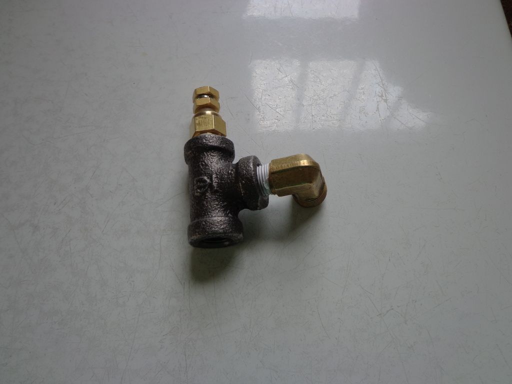

    Got the the plumbing ready for the temp and pressure senders on the engine. Oreilly's had to special order the temp sender so it took all week, lol. They also didn't have a toggle switch I liked so that'll wait until the next Springfield trip so I can goto Radioshack. I don't want a monstrous switch on the pillar, I want something smaller, but still easy enough to flip. Here's the only pic so far, it's pretty intense:
