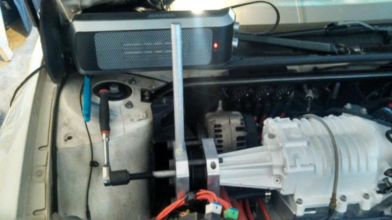

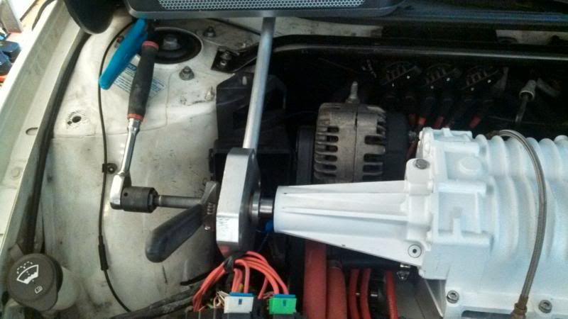

    Pulley coming off
    *Super keep your hand warm 9000 works like a charm*
    Hub going back on
    Tiny pulley and 8-rib belt on.

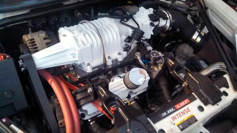

    Rerouted all my vacuum lines to hide them better, came out really nice. I still need to open the wiring harness back up and extend the TB connections now that the IC is on and they just barely reach, along with rerouting some of the wires again.

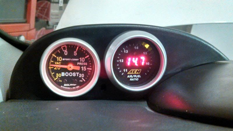

    Plopped the 3.4 pulley on (still on stock injectors) and come to find out a 685 belt is too short. Needs a 690. So I said **** it and threw the 3.0 on there with the 8 rib 680, and am diligently keeping an eye on my AFRs and knock. So far I've got almost 1/2 throttle and just saw a blip of knock and let out (about 1.5*) Made 8psi though. Should be getting the injectors sometime next week, and until then, it shall be a garage queen.

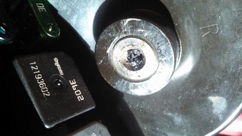

    Come to find out the plastic barb thing was brittle as hell, so I had to contend with this
    Ended up hitting it with a torch for a few seconds, then stabbed a 45* pick in there, let it cool, and it yanked right out.

    Looking good. Should be a whole lot quicker on the 3.0. A little tip for next time on the plastic plug in the supercharger is pry out just enough to grab it with some pliers then unscrew it. They break every time I have tried to just pull them out. I have not broken one since.
