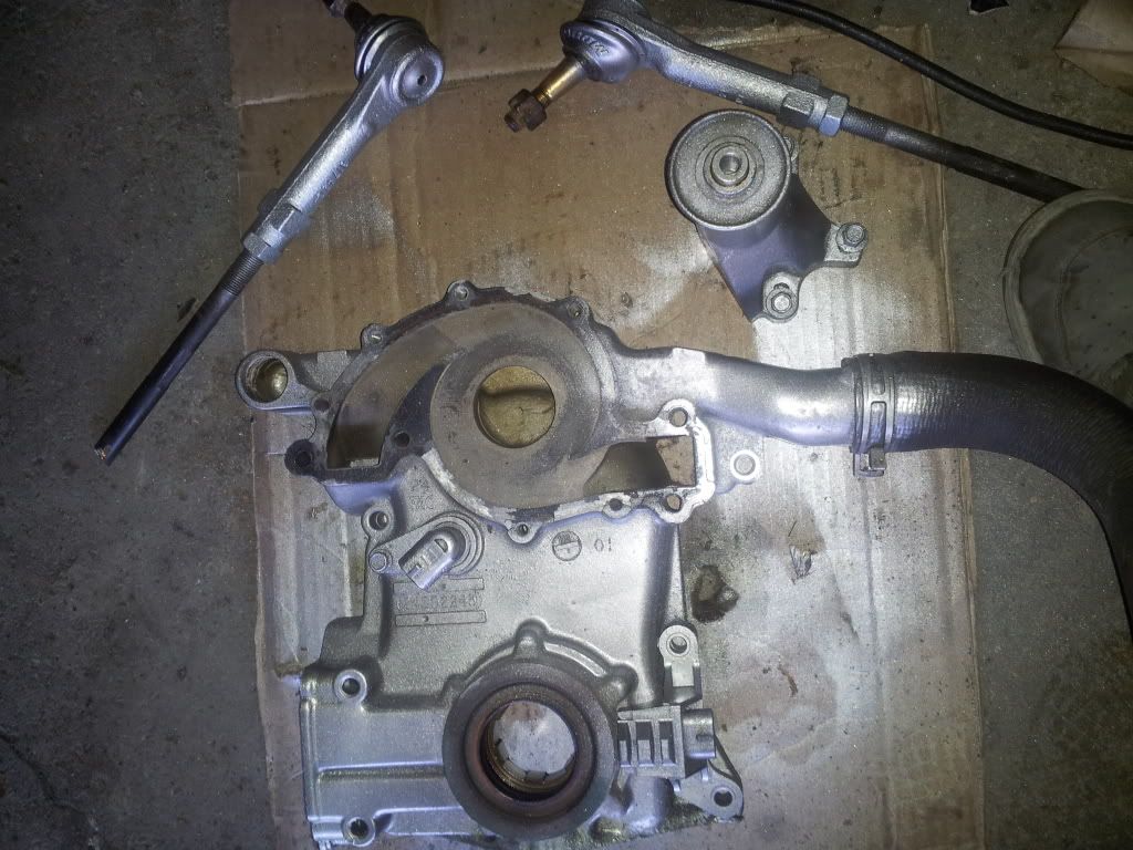

http://i1341.photobucket.com/albums/...pseb6396bb.jpghttp://i1341.photobucket.com/albums/...ps40dc80ef.jpghttp://i1341.photobucket.com/albums/...ps127b6bee.jpg so I painted a few things more and I got the cam and lifters in and I gotta wait for my chain to come in the mail still =) I can't wait

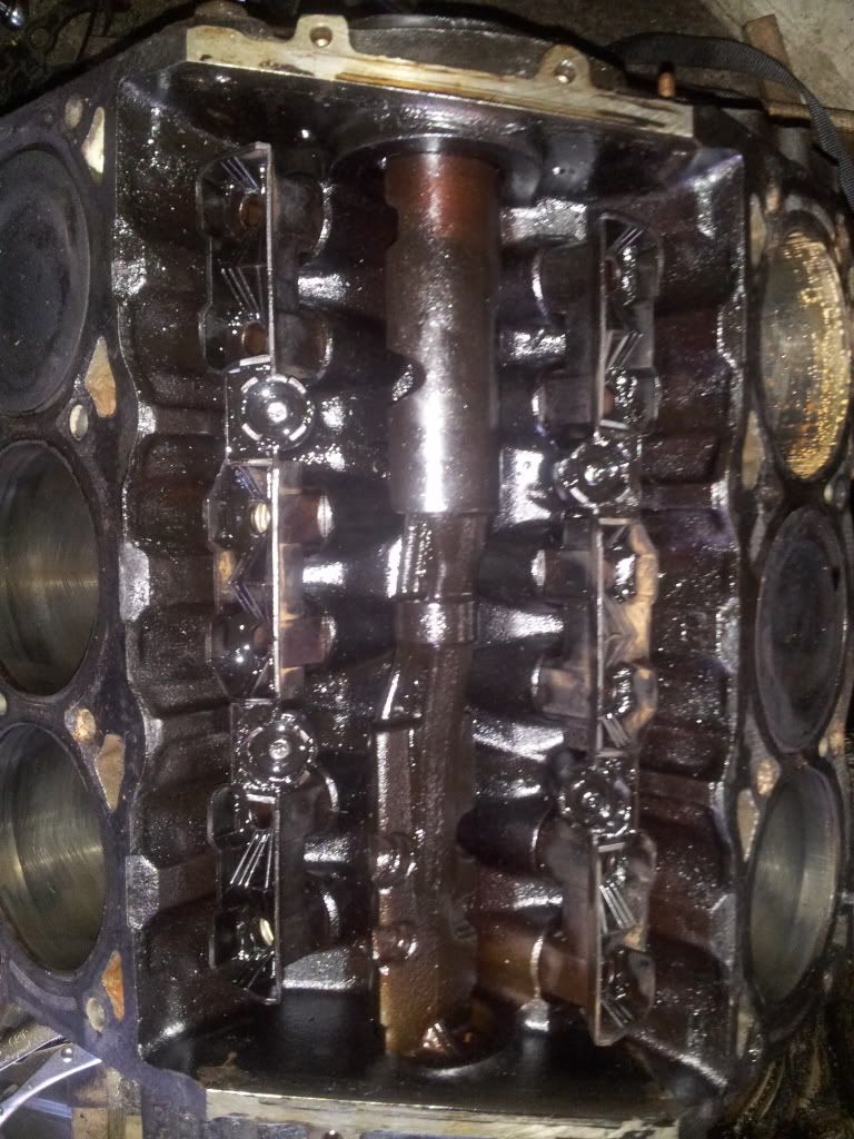

Oh I get it, I dunno why I thought you had both of them torn down. You gonna clean any of that sludge and such off while you have all the lifters and such out?

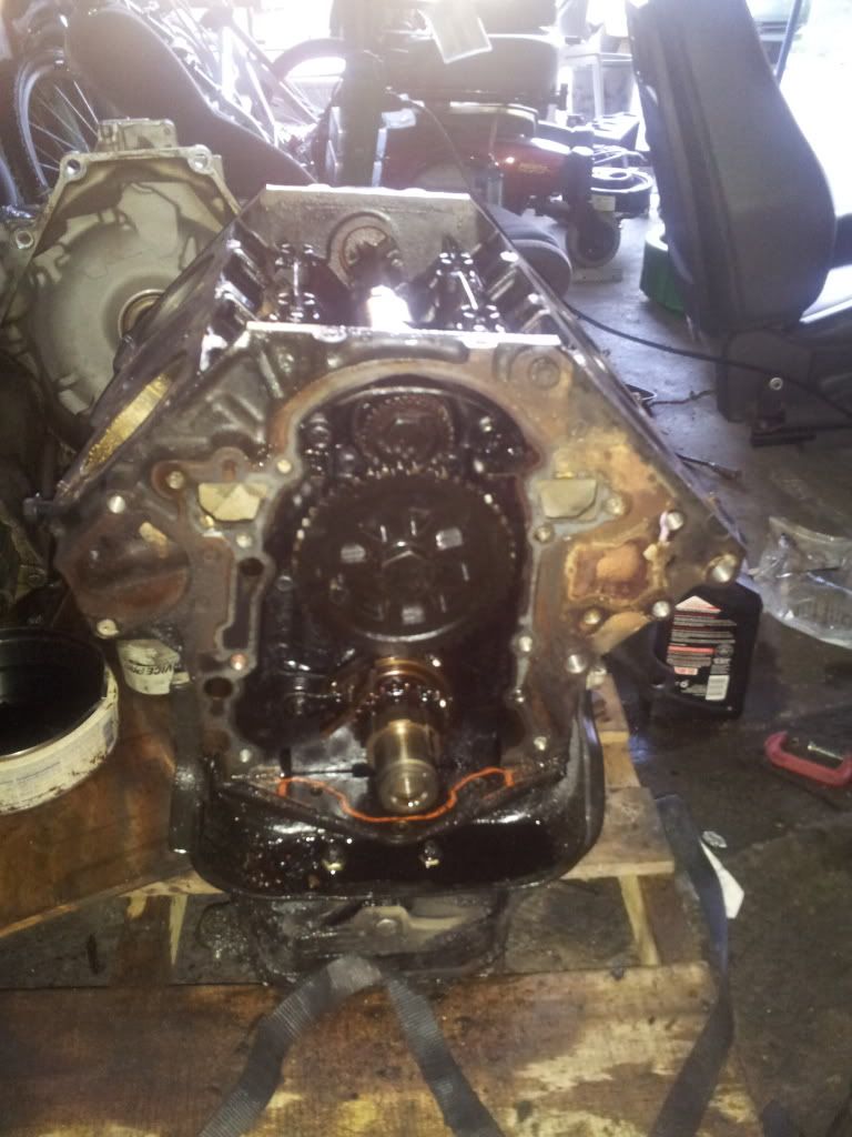

Its burnt on or something im thinking of spraying it down and when I have it lifted up ill drop the oil pan, but its just on a pallet for now I can't lift it right now
Yea, having the cam out completely will help a lot, on my motor I still had the cam in, but I took the lifters out. I had the oil pan off, scrubbed at it pretty good, then poured some cheap oil over everything like 3 or 4 times to make sure any debris was washing down.
I need to make a stand at work today (home depot lumber guy) and set the motor on top to pull the oil pan
Ok I picked up some az engine degreaser if I use that I should be fine right as Long as I run oil through?

Haha already sent them a email about it =) yeah I want a dark cool, but I got the sludge I want to clean the inside of the motor before it gets put back together would that be fine
Brake parts cleaner >_<
