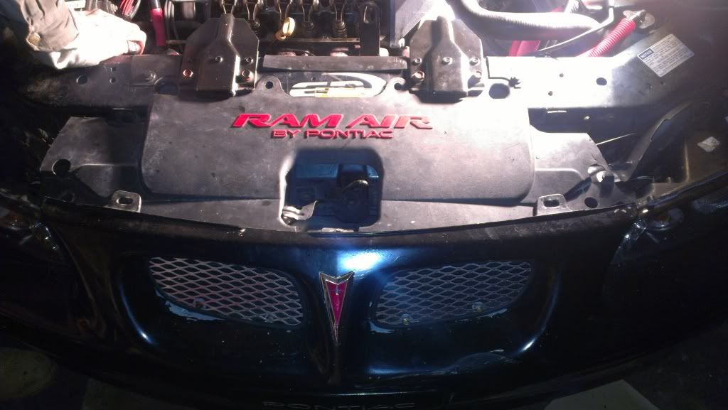

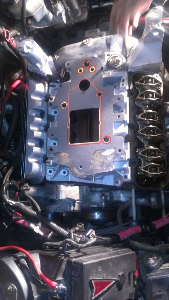

So can I came across some problems last night couldn't remember where everything went so I've been looking up some diagrams think I found 1 now hopefully it should be back together soon
http://i1341.photobucket.com/albums/...psaf069b46.jpg
http://i1341.photobucket.com/albums/...psdcdab665.jpg
http://i1341.photobucket.com/albums/...ps88945448.jpg
that black wire in this pic by the end of the lim, bolt that back to the coil bracket bolt iirc,

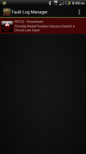

Got my car to start cleared 2 out of 3 codes last one is p0122 new coils new tps new spark plugs new wires could it be the ignition module?

http://i1341.photobucket.com/albums/...ps6cd2d10a.png
Check the wiring and or pins on the connection to your TPS(throttle position sensor)
Pull your tps and clean it.
It's brand new tps? And I'm looking at the wires now
Wires seem ok
Could be faulty?
It's gotta be something simple LOL, take a break, drink a beer, then figure it out.
I switched out like 5 of them from az
Try 6 :) but seriously if its that duralast crap well they tend to be crap but chill out enjoy a beer or two and then get back at it
