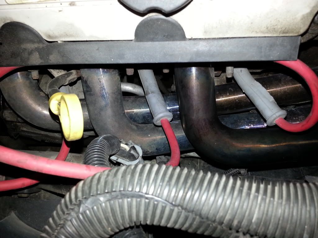

If you could some time when convenient, post me a picture of them? I would love to leave the stainless finish as it is if it will last a decent amount of time..
They are dirty as hell but i'll post up a pic in a min
And it's a Fiero so clearance may not be a issue for you plus your a welder anyways so no issues if you have to hack em up lol.
I haven't cleaned them at all since install in 6/11
http://i1130.photobucket.com/albums/...204_193051.jpg
Definetly have the rainbow going on, but I just may leave them uncoated...
I am using the gtp motor and trans, so all those clearances are the same, but surprisingly there is more engine bay space in the fiero lol, only problem is squeezing a muffler in there somewhere, but I have done a good amount of research to what others have done on fiero forums.
Thats after a winter and salt too. I'm sure they would clean up good with some elbow grease
I got mine used from a member here, they look just like that. Copper tinted with underlying rainbow color. Really interesting looking, but VERY functional and no leaks. I love them. If you want to coat them do it before you install them, otherwise just let them change.

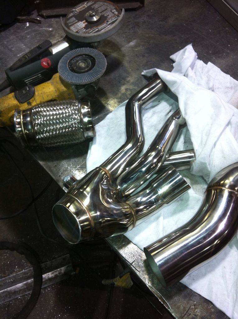

Well I found some time at work today to do a little bit of work on my exhaust, and attempted with every pulley puller we have to remove the blowers pulley... and looks like I will be renting one from a vendor! lol I also stripped the hole on the tip where the stock pulley's bolt goes... hopefully this is not an issue down the road!
Removed the what I have been told is "crappy" flex that came on the speed daddy headers. Already have a ZZP 3" purchased.

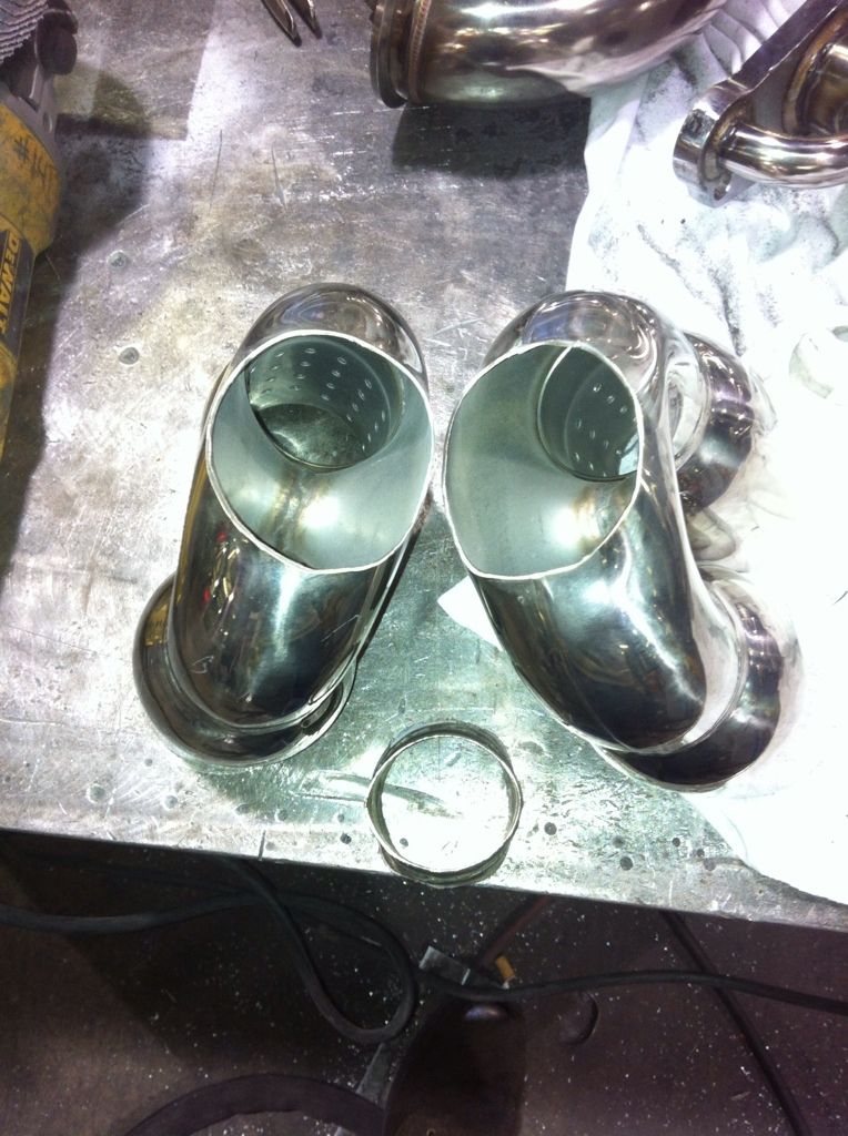

Increased the C6 Corvette tips inlet from 1.75" to 2.25"x2.75"ish
http://i1352.photobucket.com/albums/...52757BC0F7.jpg

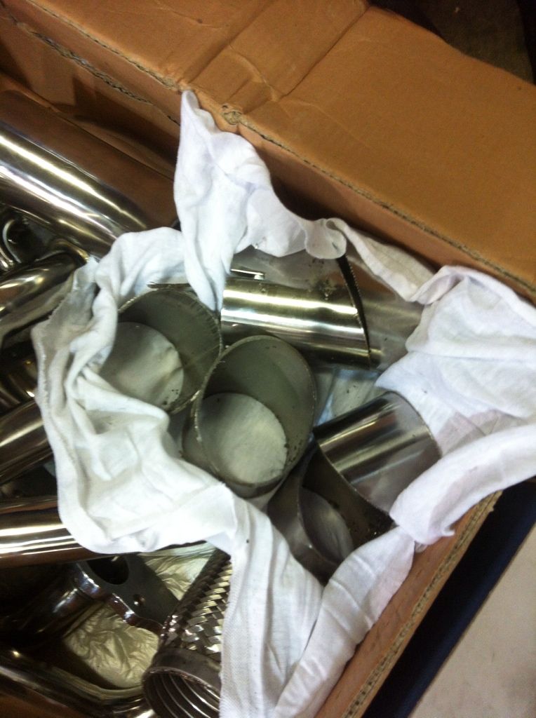

Well today was pretty busy at work, but I did manage to cut some metal for my complete 180* U bend for the exhaust.
http://i1352.photobucket.com/albums/...0A56040AF9.jpg

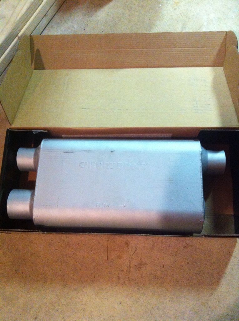

And got almost the rest of my black friday purchases today!
Cherry Bomb Pro chambered muffler.
http://i1352.photobucket.com/albums/...0A607D1590.jpg
single 3" in and dual 2.5" outlets

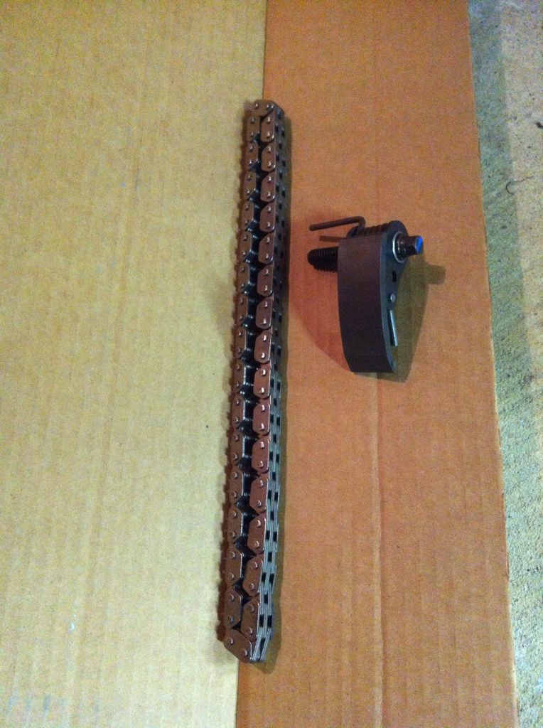

new timing chain and dampener

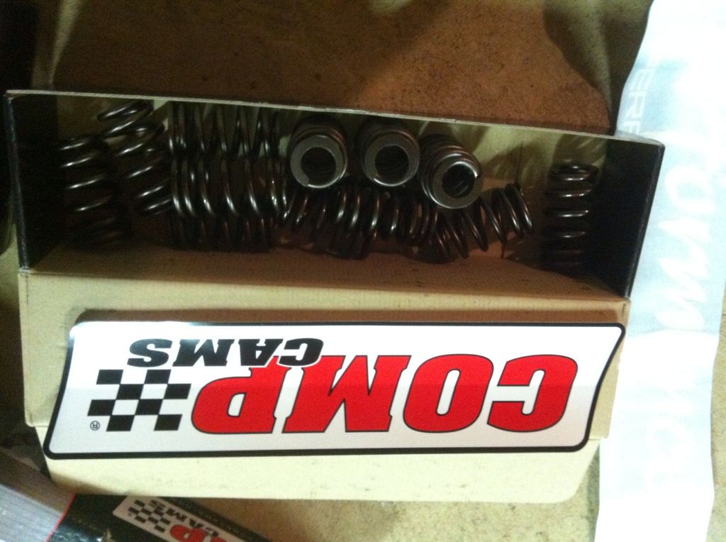

comp cams 105# springs
http://i1352.photobucket.com/albums/...0A79E11596.jpg

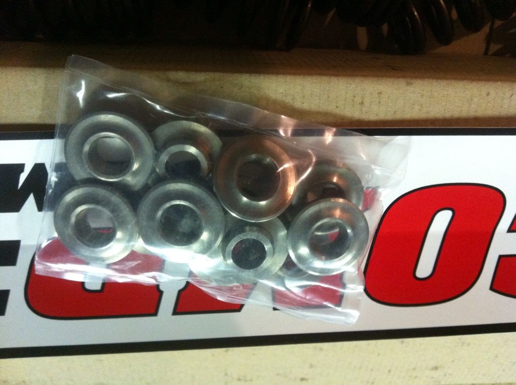

modified titanium retainers
http://i1352.photobucket.com/albums/...0A7CCC7FFF.jpg

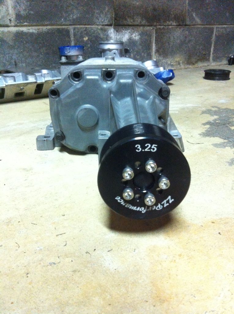

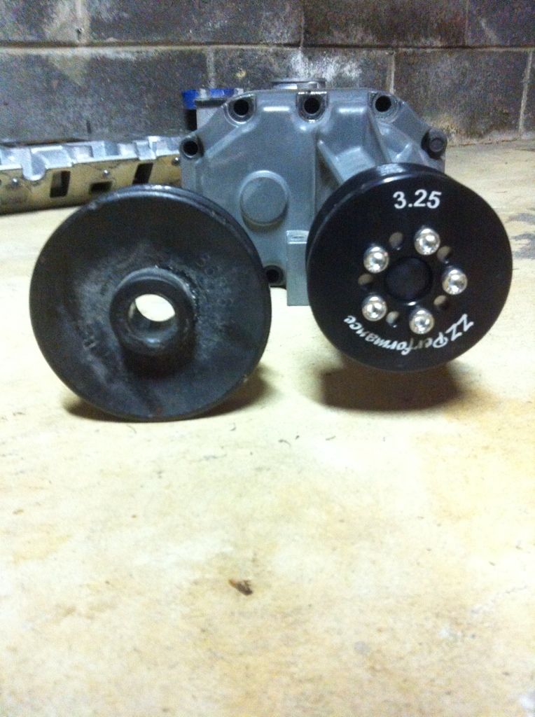

Got my cam and timing set installed over the weekend, did some port work on the second head, and got my MPS installed... After using the ZZP pulley puller and seeing how simply made it is yet how affectively it works I am going to be working on making my own copy of it at work today! More pics to come soon!
http://i1352.photobucket.com/albums/...D43982E625.jpg
http://i1352.photobucket.com/albums/...D426831DE7.jpg
I may be dreaming, but I think with mods I have done I should be able to get a 3.1 or even a 3.0 pulley dialed in once it comes to dyno time. A local I met on here refered me to a great dyno tuner, he told me he took his GP with just bolt ons and a ZZP 1.0 there and they managed to get 75 more horses out of it!
