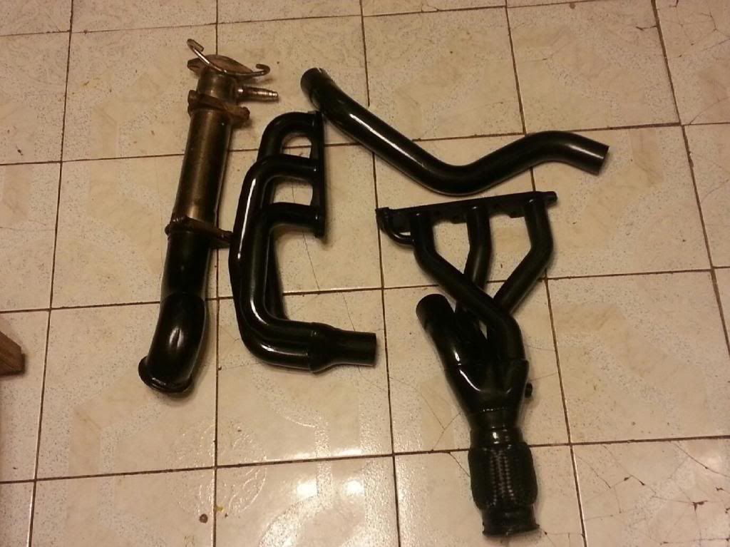

    and the mods begin!! i bought these speed daddy headers from a guy for 160 dollars. they are powder coated and are leaving to come to the right home on saturday

    When you put the rear header in from underneath without lowering the subframe, pulling the motor forward etc etc... laugh at all our w body buddies. It's so easy to do headers on your car.
    Question for you... let's see if you've been reading up and researching. What gaskets are you going to use for the head to header connection?

    the guy said he was sipping me the kind i need. he said he bought 2 extras when he bought his gaskets just in case. soo im hoping the are right. and i dont know

    he says they are new felpro

    Ok...so you know you aren't going to use them...right? You are going to take your factory gaskets off, wipe them down and reuse those beautiful and wonderful mls factory babies.

    so not using felpro?
    which one am i using?
    whats wrong with felpro
  15. #75 Re: project 12s buick (engine tear down)
    Well...nothing really. But the factory gasket that is already on there, is going to seal w/o any issue and if you ever take the front off (say to swap a motor) it's much cleaner and easier to work with. FelPro one leaves crap on both surfaces
