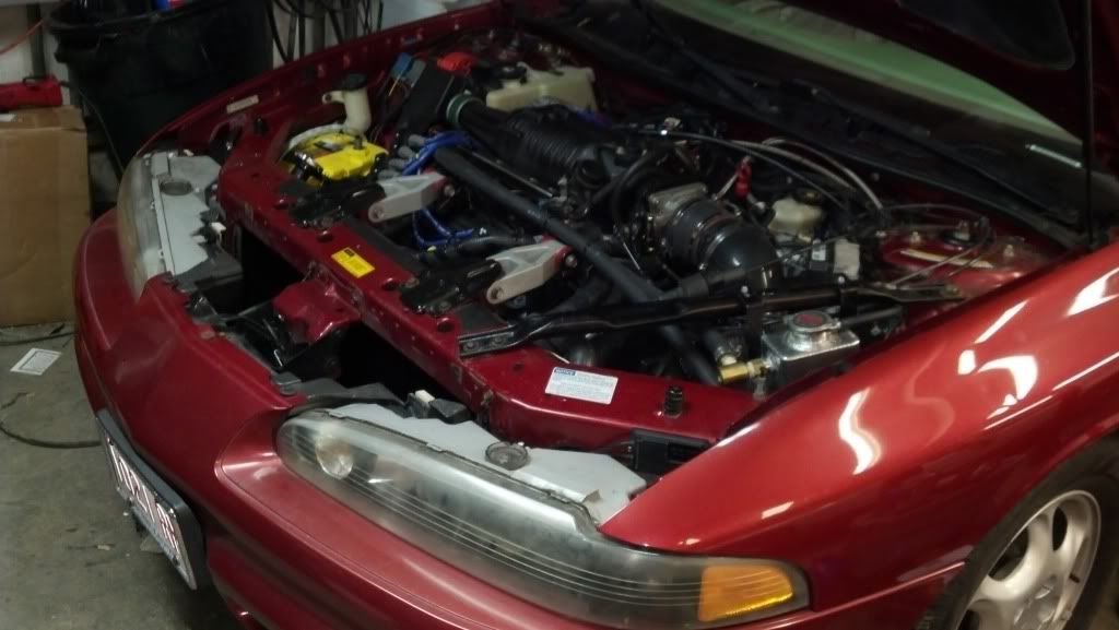

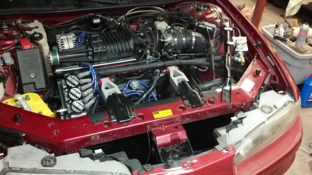

Well, we easily removed the rear servo and after comparing a spare trans on the shelf (yeah, pretty sure there are three spare 4t65e's in the garage lol) we verified that the band moved on us. We were unable to get the band to move into place so we began to pull the transmission. Won't be touching the car until Saturday so if all goes well with the teardown we may have it running the same day.
Before the teardown.....
http://i116.photobucket.com/albums/o...-14-37_878.jpg
http://i116.photobucket.com/albums/o...-14-49_904.jpg
http://i116.photobucket.com/albums/o...3-15-15_50.jpg
Where we left it for the night....
http://i116.photobucket.com/albums/o...-48-17_266.jpg
