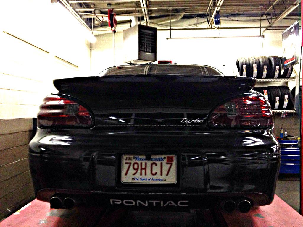

  3. #3 Re: Swiggles is going turbo!!!
    Quincy, Mass
    2,225
    Put on the turbo emblem while Joe0813 did my alignment. Not sure how i like it yet, i order a couple other ones that I'll try in the spring when its warmer out.
