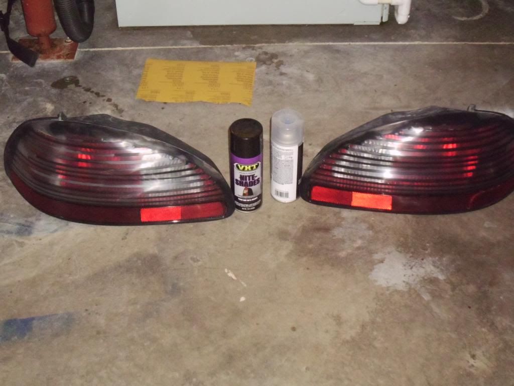

    VHT TIME!!!!

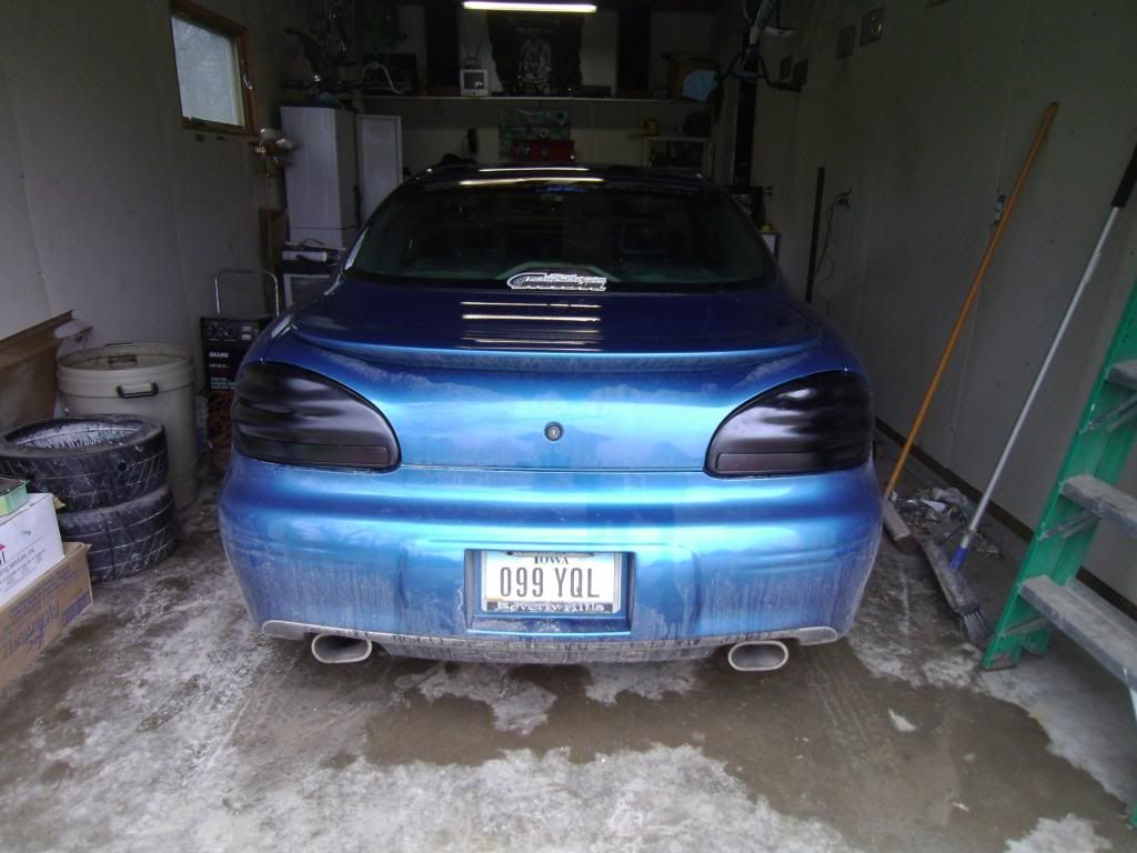

    put the tail lights in jamin to marky mark, i think they turned out ok
  7. #7 Re: Ty's 1999 GTP
    Nov 2011
    Omaha, NE
    1,391
    Can you still see your tail lights? They look pretty good...could use some wet sanding though.

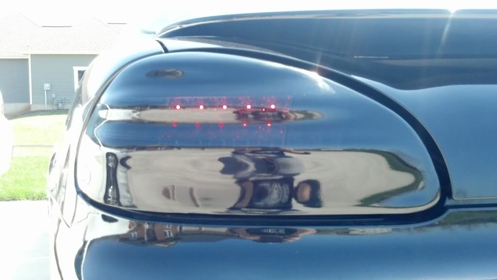

    They dont look very glossy.
    Wet sand them with 2000 grit paper, and use lots of rubbing compound to get it out.
    I used, Meguiars Ultimate Compound x2, Meguiars ScratchX x2, Cleaner Wax x2, then a week later used some wax again. Take your time, and yes your arm will be sore when done, but when done properly, it will come out like glass. Here's mine for reference I did the other week:

    Yeah I will do that, they did not seem that smooth when I was done, Thanks man!

    I sanded them and used that Meguiars Ultimate Compound and they looked good thanks Dan!
