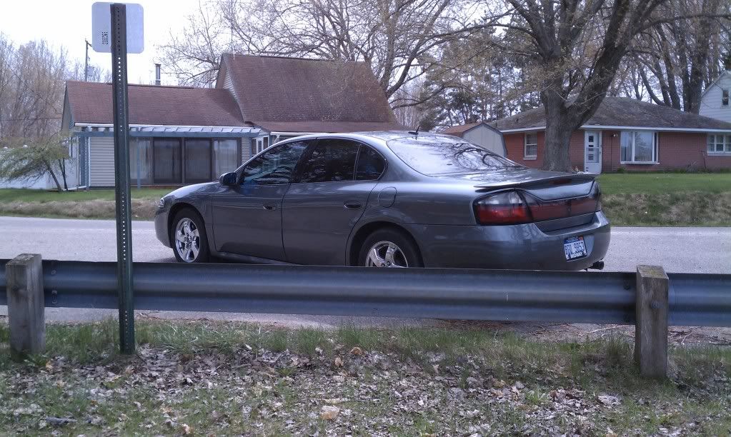

    I am relatively new to this forum, but have been a 3800 enthusiast for many years. My current DD is a 2005 Bonneville SLE which I have done lots of mods on and preventative maintenance. Pictures of it are shown below.

    Some pics of my car..

    mmmmmm bonneville
    I like.

    HAHA, yea, she's my baby. Took me 4 months to find that car since I wanted the 05 SLE (didn't want GXP with northstar V8) and wanted to be a GM certified used car (within 5 years old and under 75000 miles). This one came into dealer with 74,664 miles and was very fortunate to get my hand on it. Have been loving it every mile since and were closing in on 104K!! NEVER getting rid of this car unless unfortunate accident takes her from me...

    Who doesn't love a Bonneville?
    Back end is up instead of GP draggin.. Ahhhhh Bonneville

    Boost - I sure get mixed reactions about my car from the population. Most people assume im driving a granny's car (which i kinda am) but they agree it's not what they expect! Sure turns heads since its not a very common car...and being debadged...I get many people asking what kind of car it is! haha
