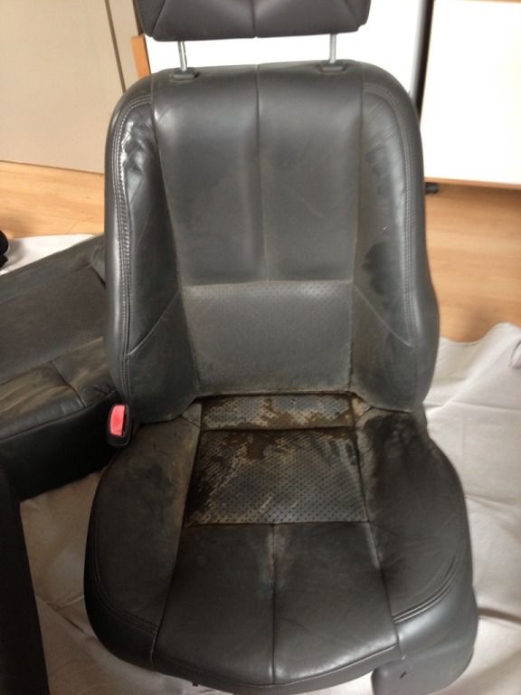

http://i693.photobucket.com/albums/v...7AC6368EF2.jpg
Drivers front, its the worst of the bunch, window was broken in.
http://i693.photobucket.com/albums/v...7ADF4F8A2A.jpg
Drivers seat , looks wrinkly, will know after cleaning, but looks good.

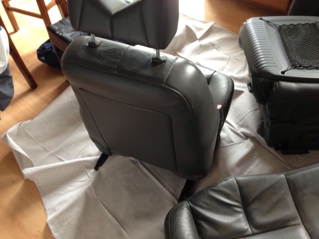

http://i693.photobucket.com/albums/v...7ADC1445A1.jpg
dirty

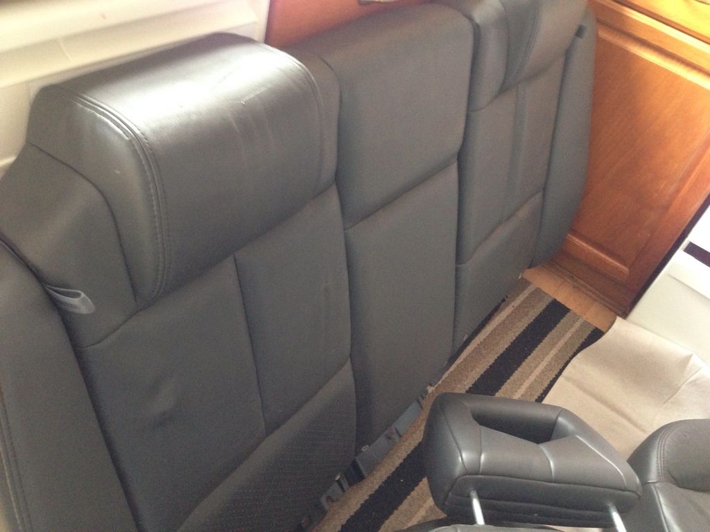

http://i693.photobucket.com/albums/v...7AD7E7BF22.jpg
rears

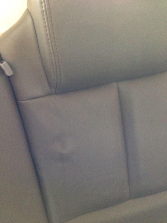

http://i693.photobucket.com/albums/v...7AD4BE7DF7.jpg
some wrinkled spots on the rear.. wonder how thoese will come out
http://i693.photobucket.com/albums/v...7AC3737F03.jpg
the rear tops are for sure dryer then the main area, can feel the roughness.

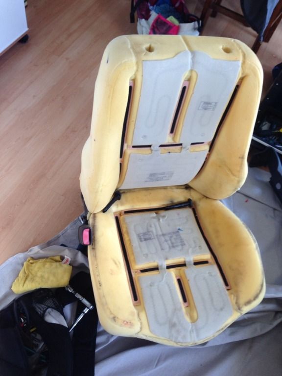

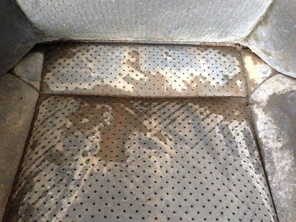

drivers side seat is now naked!
http://i693.photobucket.com/albums/v...83BAB99EF7.jpg
Now i gotta figgure out how to dry it out something fierce

dont force the leather to dry, lay it out let dry on its own. if you can keep it taunt that should help it keep its shape. books under it to hold it. you know, be creative.
the foam, you can keep pressing with a towel to soak up the wetness deep inside, but it sucks. like never ending. once tired of that, if you got a window that has direct sun all day. let it sit there, rub some baking soda on the foam. (while wet) that will kill any odors.
shop vac or beat the crap out of them outside to get rid of the baking soda. dont use your house vac, the b/s is so fine it can kill your house vac.
ive got a Little Green carpet cleaner, its a hand held thing so im gonna use that to suck out the water from foam.

thats only gonna take so much liquid out of the seats. trust me. been there, done that lol sun, and a few days in a warm sunny environment will dry them up nice.
