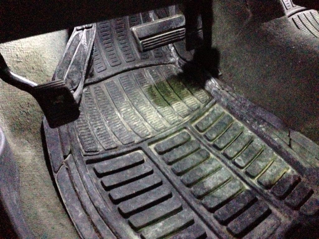

i did remove the crappy LED stips from the foot wells and replaced with 194 LED bulbs. so ill get some night pics at night lol

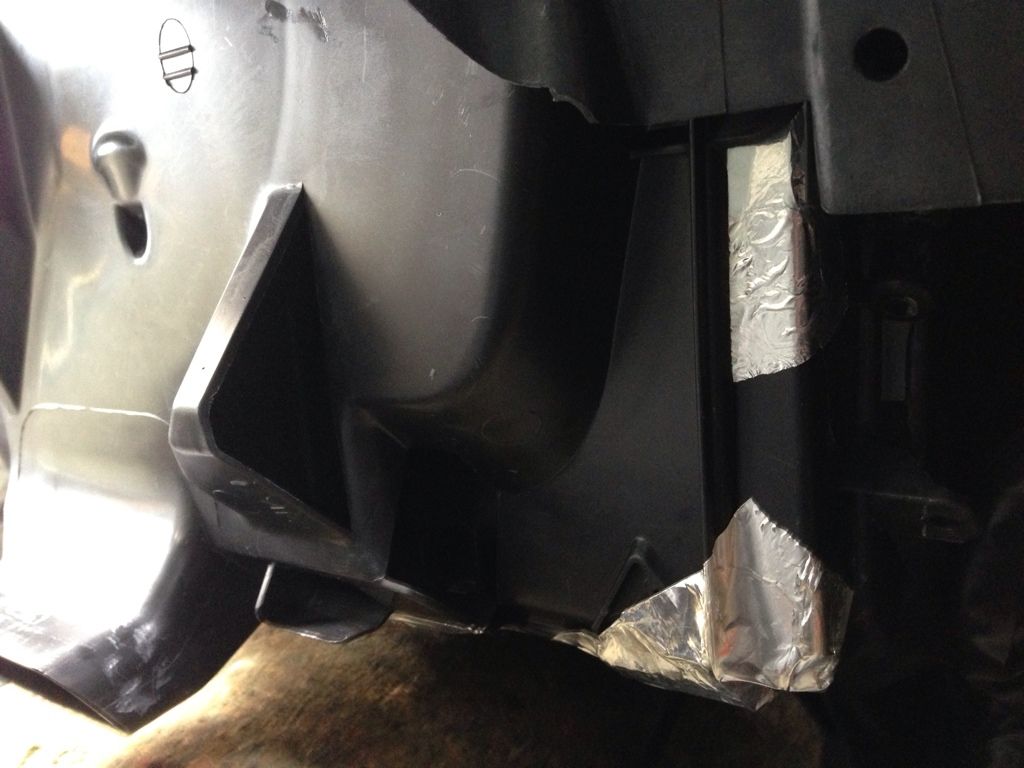

the duct was being a dick, so it got cut in half to get it outta the way... this is how i fixed him
http://i693.photobucket.com/albums/v...7861B84C23.jpg
Toasty,Bro.
is the tape cuz you didn't have screws? I wouldn't trust it for too long on the box part
all-in-all how bad was it? I'm mean if the back prob wasn't in the picture.
its HVAC metal tape, it will last LONG time... i didnt bother buying more screws, it actually went together fine with the ones i had, jsut shuffled around a bit.. the box cover is really just a diverter, so if it doesnt divert AS much, still heats the car lol
i think all and all it was "easy" to do, wasnt lots of complicated steps, just stupid with the whole requirement to break things.
the tape was used to fix up some broken bits.

(all i changed today was foot wells, lost the semi blue strips and did 194 bulbs instead)
