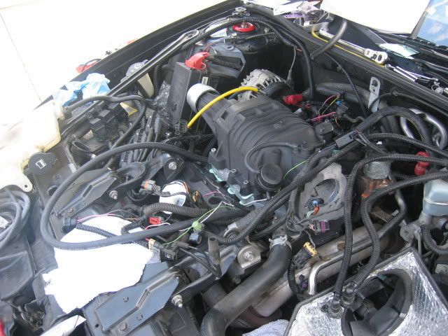

    i got my title at work and a retro check so i decided to up the ante and go supercharged...i got a deal on some SSM90 rails and manifold for $200 and just pieced together the kit as time went on
    Supercharged mods were:
    L36 bottom end
    ZZP SSM90 kit -3.4 pulley

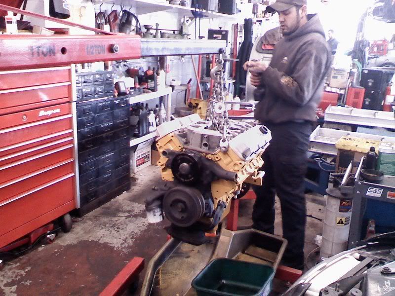

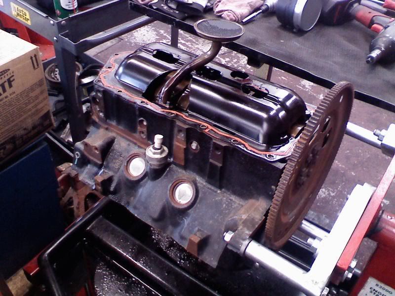

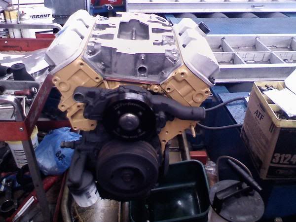

    christmas 08 the grinch brought me a chipped piston...santa followed through with a l32 from morad rebuilt by tune time

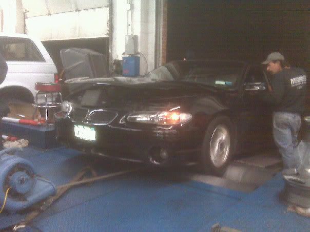

    supercharged she went consistent 13.0-13.2 on the meth, made 260 whp and 300 wtq on tune time mustang dyno

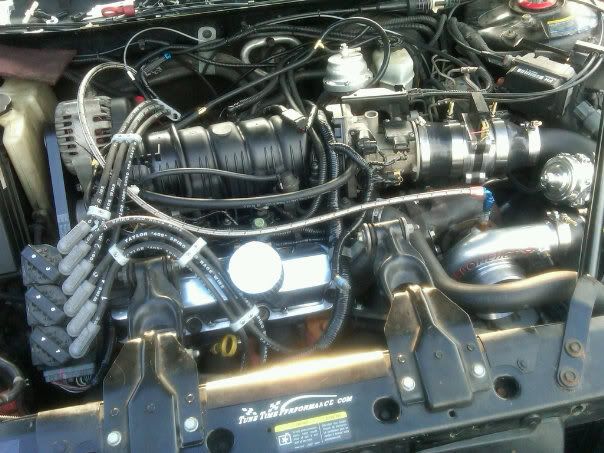

    the thirst for more power and right timing brought me to a used z7 kit and a kid looking for a ssm90 kit...i managed to strip off the tog's take apart the top of the engine and install the turbo and ship everything out in a matter of a 4 day weekend from work
    the turbo mods are:
    ZZP front and rear power logs
    ZZP hv3
    ZZP Z7 kit with 62-1 turbonetics turbo 38mm tial wastegate and 50 mm bov
    so here we are, tuned and on meth she mad 305 whp and 355 wtq first time at the track was a 13.0 @ 104, then 12.8 @ 105, and finally 12.7 @105, just for kicks i launched at 3 psi of boost, smoked out the tires to the 330' mark got off it and hit it again to click off a 14.60 @ 105 im in the works of getting a better turbo and installing the bigger injectors. i know she has 11's in her but i need a beater and some more cash...hope you enjoyed the story gpers!

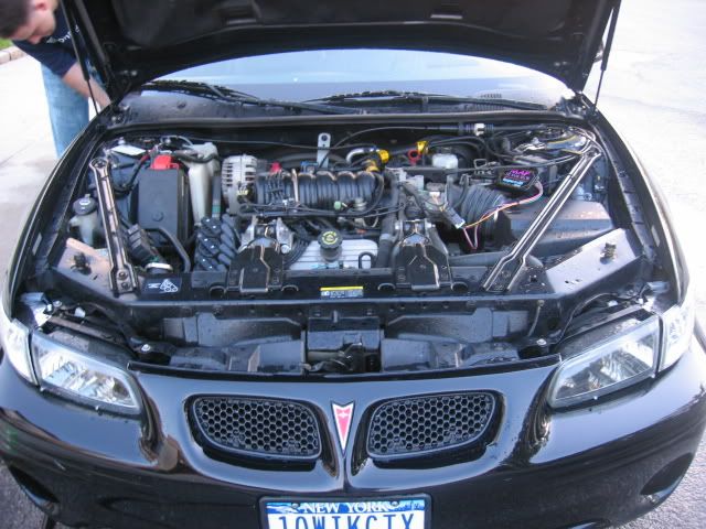

    What paint was that on the charger and valve covers? looks sick and may have to duplicate.

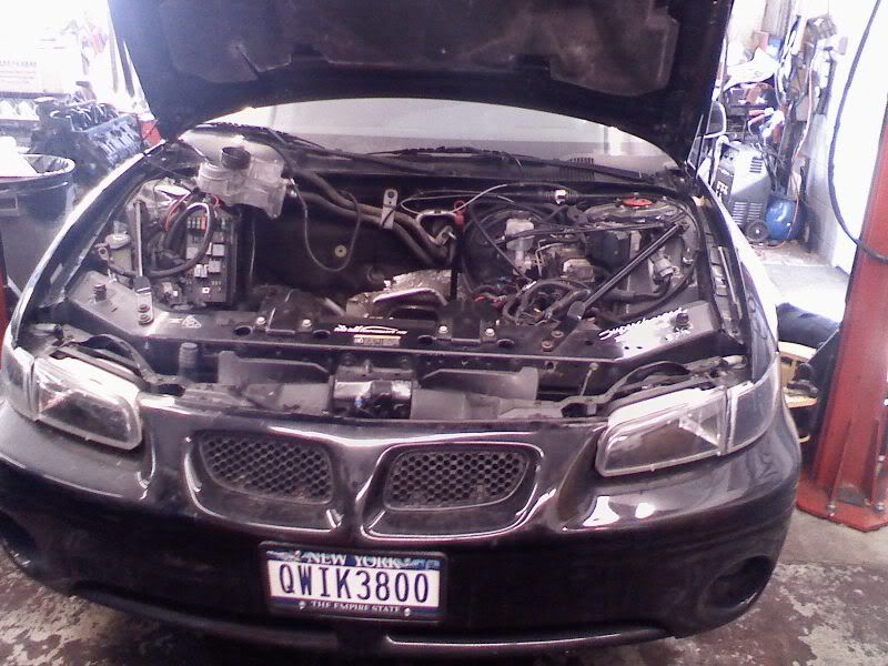

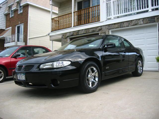

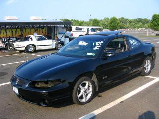

    wow, that's some serious wrench time. the 18's were sexy. did you ever think about lowering or are you just concentrating on the motor? and in the second pic, are those torque stars on the front with just really low profile tires?

    Paint on the blower is rustoleum BBQ paint...$4 a can baby!!!

    The car was always lowered. Used to be ssc springs on gr2s which rode like crap here in NYC. I switched to the original GMPP/Koni strut and spring package. Those rims are torque stars with a road race tire I used as a radial. I've since painted them black and added the Hoosier QTPs

    The 18s are fittipaldi force. I wish I never sold them.

    for the m90 kit you pull off the stock l36 intakes, change to the gtp coil bracket. if you choose to use the ss pulleys you need to install the pulley zzp gives you. i upgraded to 42.5 lb injectors. you need zzps fuel logs specifically for the m90 kit. you also need a pcm tuned for the blower

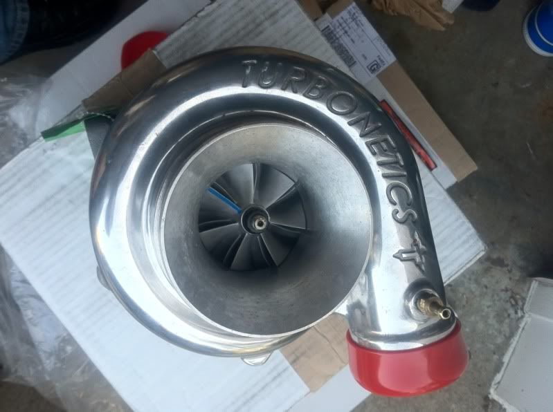

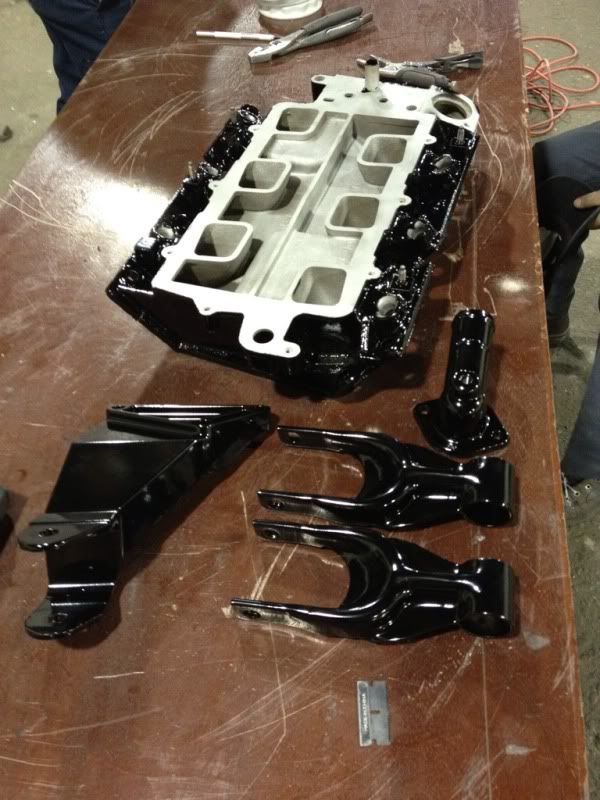

    I've done some more work to the GTT so what better way to show than to pic whore!!!!
    Got the turbo rebuilt from Turbonetics
    Got majority of the underhood parts powdercoated glossy black like an AMG baby!!
